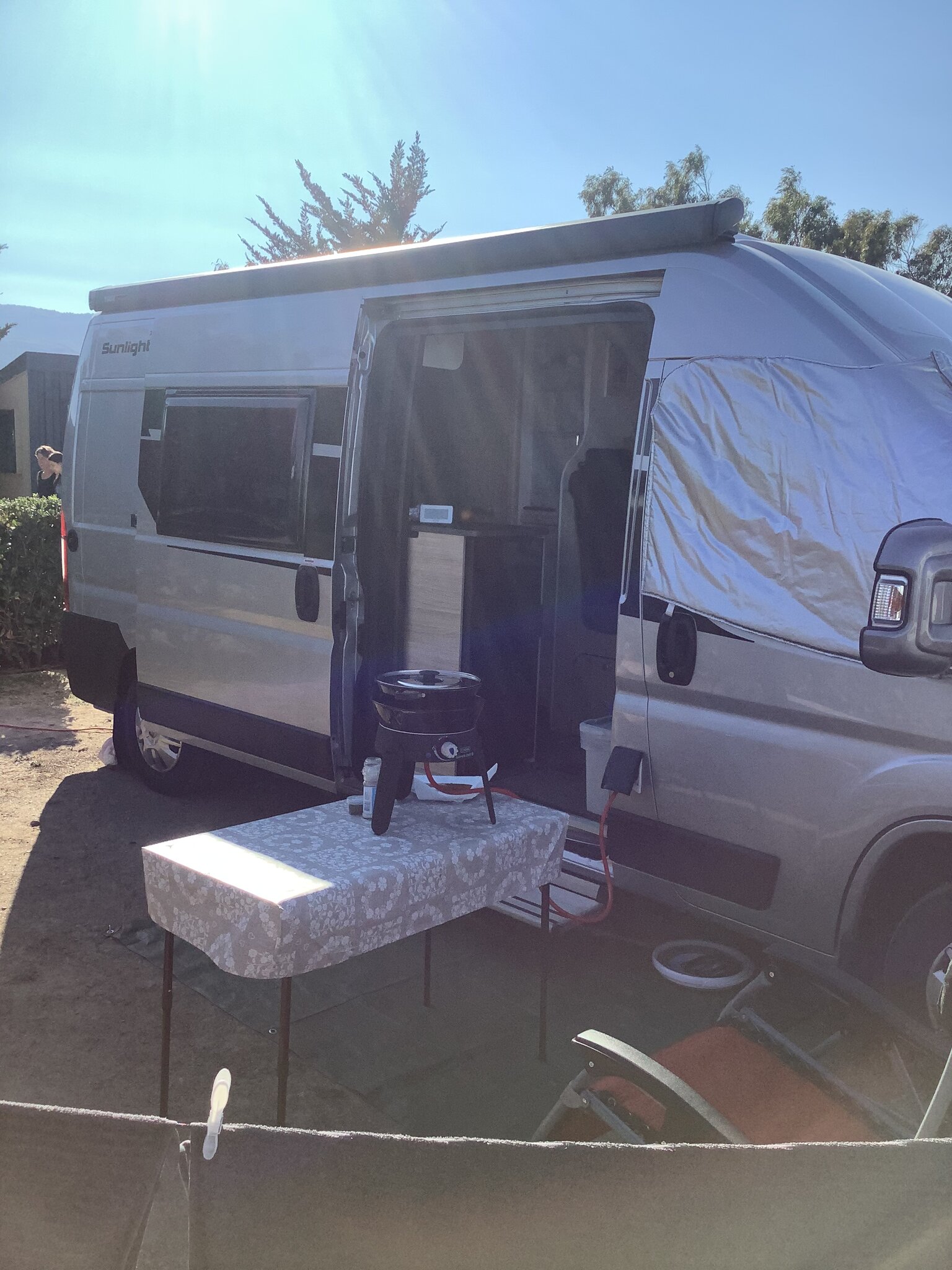

you don't say what m/h you have for room just get 2 /6kg refillable gaslow or similar we have 2 /11kg bottles gaslow & take a repsol or cepsa spare bottle because you can exchange it anywhere in Spain . if you have an outside BBQ outlet you can use it this way

hi . sorry late reply no we take French bottles when going to France & Spanish bottles to Spain as we go to Spain in the winter & France in the summer this is our French bottle . we do this so we have some gas in reserve & us it for BBQ
