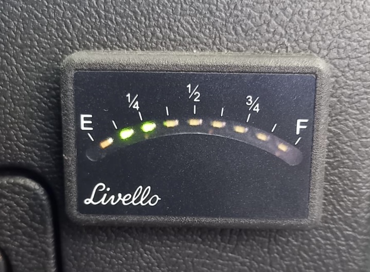

The "Gas It" gauge in the van says we have 4 bars left in the gas tank Can anyone tell me how accurate they are? Are they like fuel tank gauges ,as in, when the get below half full they seem to fall off a cliff!
Note: There are 10 bars in total on the gauge.

Yours will probably have the same size tank as ours and when full contains 20 litres, coincidentally our gauge is showing four bars and from experience that’s approximately half full, if I fill up tomorrow it’ll probably take 10 litres. I use the app My lpg.eu which shows me 3 different sites within 9km between 60-99 cents per litre at the moment in Germany. The gauges are only a guide, best not to run out.
Is that the little plastic one on the neck? If so, no, not accurate.
The one I had and I believe the OP is referring to as he said the gauge is in their van, is this LED gauge.

I filled up with gas this afternoon when the gauge displayed 3 bars, after topping up with 11.8 litres the gauge showed full.

That's meaningless unless you were watching the LED gauge as it filled as it may well have registered full when you had only put say 9 litres in.
The LED gauge we had on our underslung would read full before it was and registered empty when there was still about 20% left in the tank, which is why I outed it for the Mopeka.

Fill it up. If its only a 25l tank the saving in France will be peanuts so why risk running out. We have the same gauge and seems to read full until half empty and then goes down quite quickly.
This gauge is a classic example of something that is precise but not accurate. It is precise because if you put in the same amount of gas the gauge will read the same number of bars. But it is not accurate in that if you add in equal quantities of gas, the gauge doesn't go up by equal number of bars.
Inside the tank is a float on a swinging arm, and the arm end pushes a rod up and down. On the end of the rod is an arrangement that makes a magnet rotate. The magnet makes a sliding resistor rotate, and the gauge measures the resistance. Even with ideal geometry, with the float pivot level with the centre of the tank, and the float arm moving from top to bottom of the tank, it won't be very accurate.
They don't do a different model for each size of tank, so the geometry in your tank probably won't be ideal anyway. However the LED bar levels will be reproducible, and if you note the bar number and the quantity required to fill up, you could eventually produce a chart showing the quantity for each number of bars. If life were long enough...
