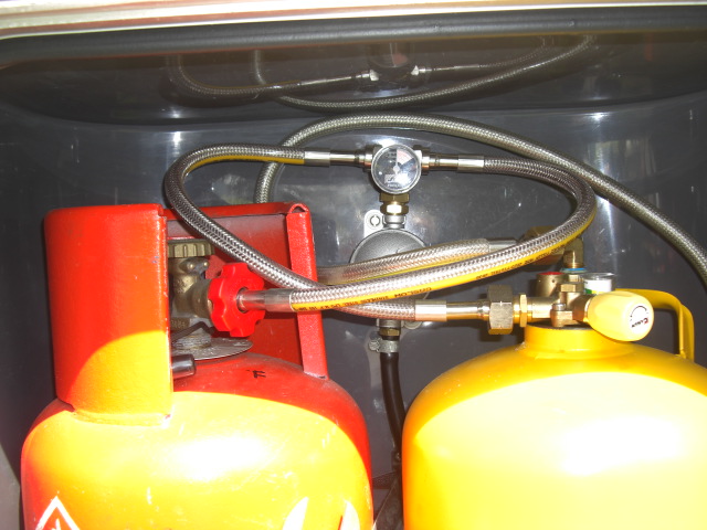

I only tour abroad and installed one 6kg Gaslow refillable and one Calor exchangeable, both permanently connected but with manual changeover (I simply shut the refillable's tap and open the Calor's tap) because I want to know if the refillable has emptied. I have not yet had to change to the Calor as abroad I'm on the road every two or three days and can top up the refillable with as little or as much as is needed to fill it, and at so many places.
