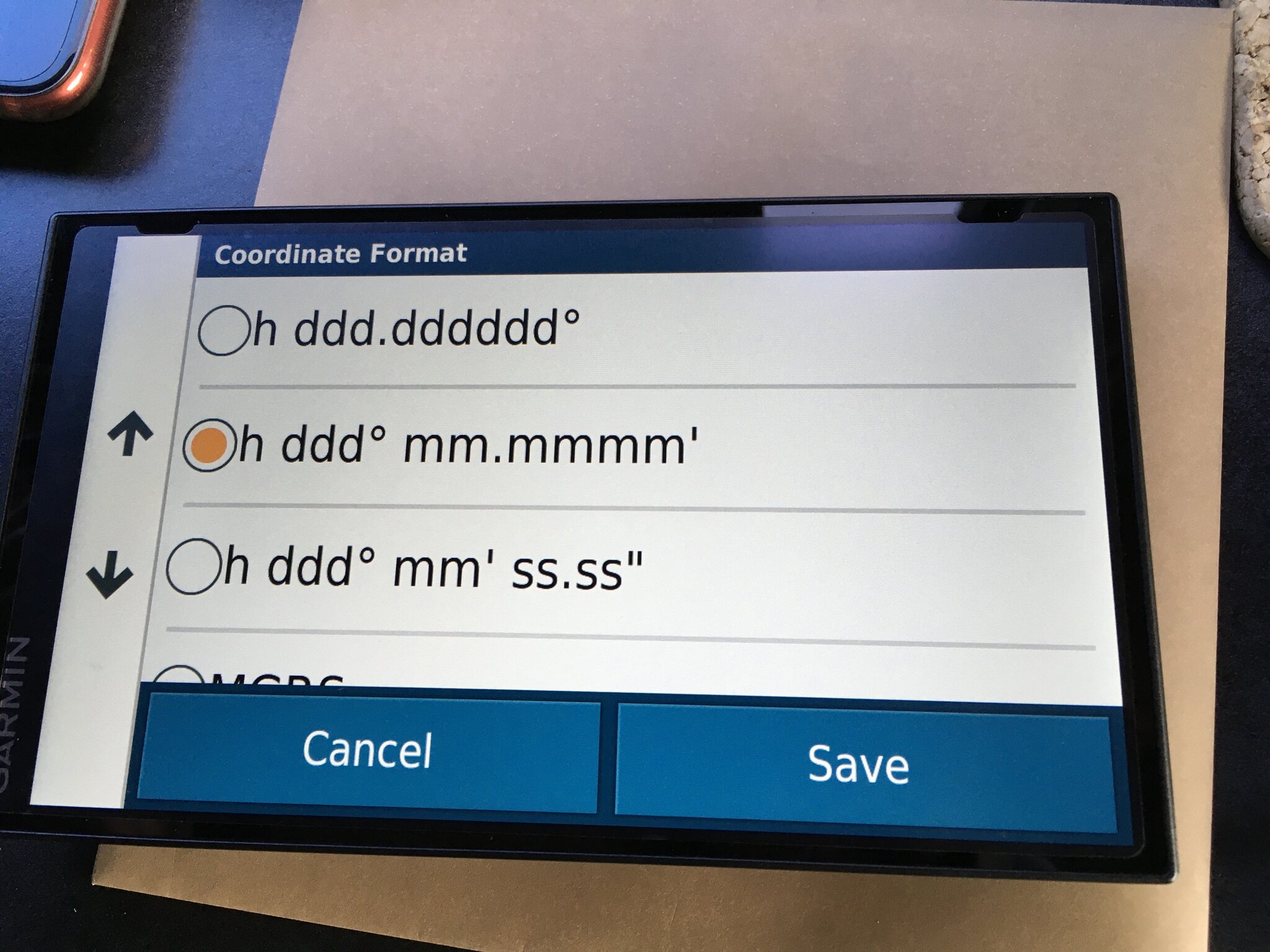

When I go into input coordinates in my garmin it gives me choice When I tap the spanner icon

Hi the ddd mm' ss.ss" option is the one
To enter your coordinate for Porto would be:
N 37° 51' 09.00" and W 008° 47' 20.00"
The coordinates are GPS nothing to do with grids, the formats are just different ways to input the same info.

Ah, coordinate decimalisation fun. It's all latitude longitude (technically it's WGS84). It's like converting prices in £sd to £ with decimal places.
The coordinate you provided for Porto is in degrees, minutes and seconds with decimal places (the third option in Manic's screenshot).
I think Garmins default to degrees and minutes with decimals.
If you take the 20 seconds and 9 seconds at the end of the Porto coords, and divide by 60, it gives you the value in minutes, 0.33 and 0.15. Add this to the end if the minutes.
008*47’20”W 37*51’09”N
Becomes
008*47.33W 37*51.15N
