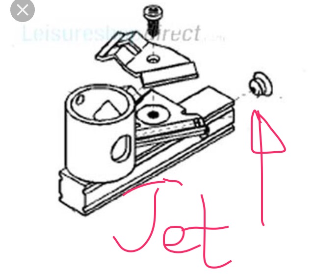

When I had the problem in 2015 with my fridge not firing up on gas the Fridge Burner and Jet were replaced so does anyone please have a close up photograph of these items in placed?

Roger, there are so many variations, so it would need to be someone with the same model and year as your fridge unit.
Inside the fridge on one of the walls, is a label with the model number on it. (y)

The flue and jet were just cleaned with a bottle brush and vac. The flue has a baffle that hangs inside from the top, be careful with that and take care with the gas jet it's quite delicate. Don't poke anything in just use a soft brush and vac, or replace if necessary.
Good luck getting it sorted.
Edit: if burner jet was replaced in 2015 it shouldn't need replacing again so just clean up.
