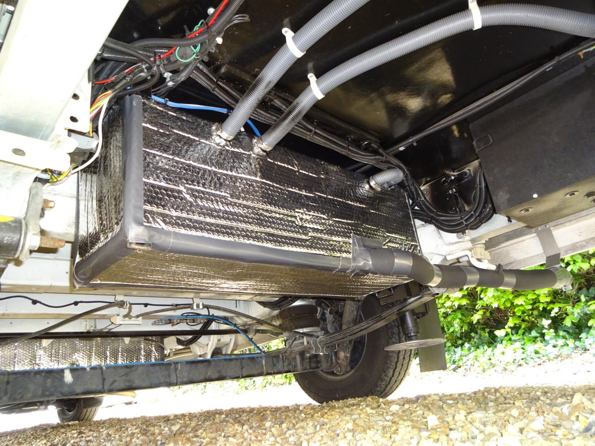

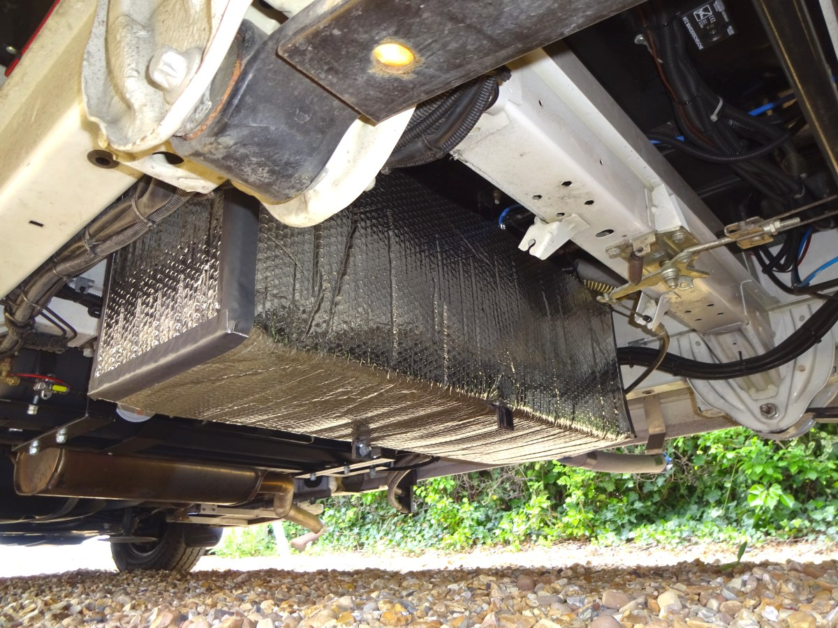

I used these as tank heaters stuck to the bottom of both the fresh and grey water tanks.
https://www.ebay.co.uk/itm/12174432...d=link&campid=5338547443&toolid=20001&mkevt=1
To stop the grey waste dump pipe freezing I used trace heating cable from the tank to the dump valve.
https://www.ebay.co.uk/itm/18556399...d=link&campid=5338547443&toolid=20001&mkevt=1
Each tank has the temperature of the heat pads controlled by a digital thermostat with the thermocouple placed on the side of each tank about 60mm from the bottom of the tank.
I have these set to come on at 3 degrees and go off at 5 degrees C.
-Broken Link Removed-
I insulated the tanks with a double layer of bubble wrap insulation which has a foil coating both sides.
https://www.ebay.co.uk/itm/29354780...d=link&campid=5338547443&toolid=20001&mkevt=1
I taped the corners and edges and stuck the top edges of the insulation to the tanks with T-Rex tape which stick like the proverbial sh*t to a blanket.
The grey waste dump pipe I insulated with Armaflex pipe lagging.
https://www.pipelagging.com/pipe-in...ulation-lagging-black-nitrile-foam-class-o-2m
Thanks for that, i`ll have a look at the links.
