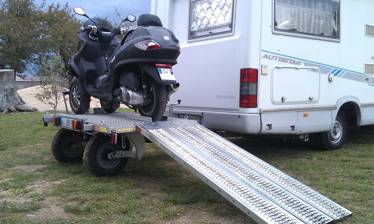

Has anyone purchased and used one of the French castor wheel trailers? If so I would welcome their feedback. I'm considering buying one myself when next in France. They are not cheap but do seem to get over the rear axle weight problem, keep the overall length short and are considerably more manoeuvre able than a standard short trailer.

The scooter I have recently purchased was too heavy for a tow bar bike rack, so I looked long and hard at the twin castor wheel and large single castor wheeled trailers.
They were not inexpensive but that isn't what put me off. So in the end I bought the largest Garage motor home with the biggest pay-load I could find so that I could put it inside and be no longer than the standard van.

Because of the castoring wheels all the centripetal force of the bike when cornering is taken on that thin looking framework and the close together lugs on the towbar. Are towbars stressed for such a side/twisting load.
I don't know but questions worth asking.
Another one I saw had a pair of ball hitches widely spaced, now that looked like it spread the stresses better.

possibly not classed as a trailer either on ferries? when discussed before I seem to remember some thought to much stress on the wheel..are they type approved in France?
Uk verison was easy lift: http://www.easylifter.co.uk/hydra-trail.htm
I seem to remember some concern over weight transference but I think that applied to a single tow hitch whereas the Tracty double castor wheel trailer has two tow hitches so the weight transfer would be a cross the whole back of the tow bar if that makes sense. My concern would be for the reliability of the castor wheel mechanism. Having seen supermarket trolley wheels 'wobble' when worn, I would like some reassurance as to how long the castor action will last and what are the maintenance costs and schedules like? If no one has gone down this road already I will do the research with the French company concerned but no point in duplicating effort. If no one has actually bought one I'd appreciate some feedback as to why not because it seems like a good solution to carrying a decent sized motorcycle

I think there were a couple of French versions, I have seen one and was very impressed, it was very ruggedly made and used two tow hitches. Looked like it would survive a Sahara crossing. I looked them up on the net and though they have a website they seem to have gone out of business. Unfortunately, I am suffering brain fade and can't remember their name but they were mentioned here on MHF last year. The other maker uses a single tow hitch and a steady bar, which is probably cheaper but looks a bit Heath Robinson to me and they weren't built to the same standard as the other one.
