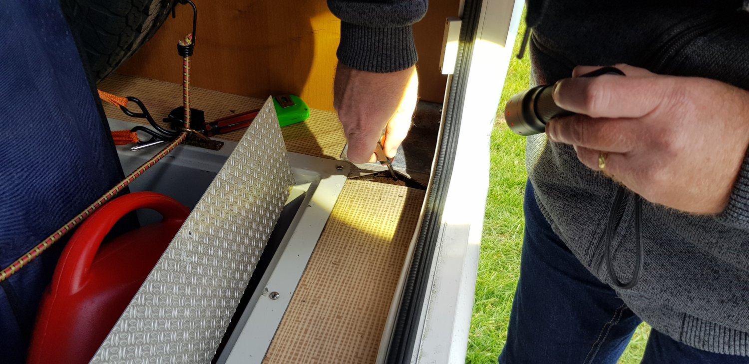

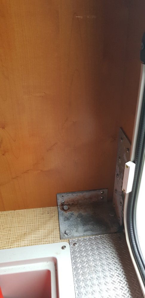

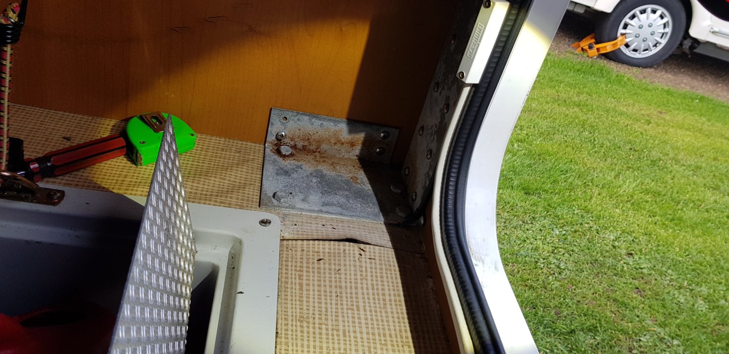

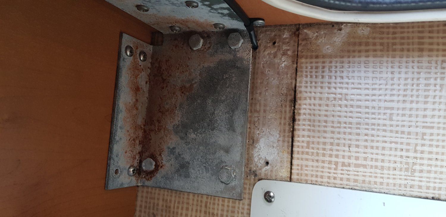

Not a happy bunny, found some damp today in the rear garage of my 2009 Rapido 9097F :cry::cry::cry:
Its the rear left hand side, wood is completely rotten under the bracket. Next to the small garage door.
It spreads to left along the shelf for for circa 4 inch.
The opposite end ie back right is 25% damp so that needs sorting also and the opposite end at the font along the side locker is also 25% at that end. :(
Looking like need to new support joist replacing.:(
Hopefully will not cost me an arm and a leg but it def needs sorting.
I am baffled as to where the leak has come from at the moment.(n)
We've had the van almost 3 years. Got a damp check done when purchased and one 12 month later by Camper uk all okay.
Never got around to getting one done last year but did it myself and did not find anything. Although cannot recall if checked garage
Checked everywhere else on van, no issues. Double check above the garage and nothing.
Stumped as to where its come from(n)
Has anyone elese experienced a similar problem with their garage?
Can anyone recommend a repairer near Halifax, or in West Yorkshire? will go further afield if needed though.

Yes sorted was told garage seals the issue which we got replaced.
Just short of a grand I think, cannot confirm exact price as the bill was was more but we got a repair done and a few other jobs sorted at same time.

We had a very similar issue with our Rapido, and the cause seemed to be the seal on the door not sealing! In fact, if you get into the garage in daylight, and have someone shot that door, you may well see where the water gets in!
In our case, the alarm sensor would, presumably, not fit with the door hinges where they were, so whoever fitted the alarm slackened them off accordingly. Unfortunately, that allowed water in when it rained!!
Not terribly convenient for you, but we had ours fixed by Les Bateman at Southend Airport, who did an excellent job, at a very reasonable price!
