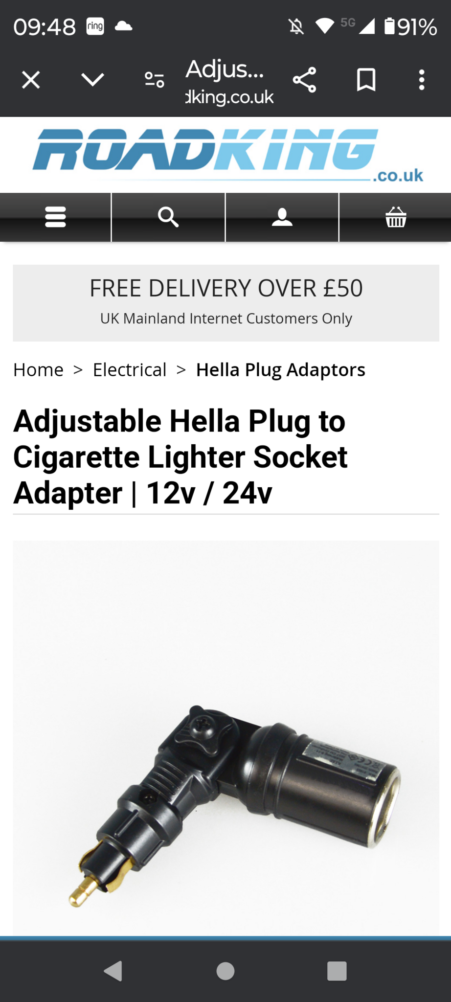

So the back end (female) is larger dia than the male. I saw a previous post so I’ll try this….very random…thanks for the feedback all. Just makes me laugh that they provide a device that doesn’t fit….hilarious.
Right apologies, it DOES fit the front main cig (180w)….i thought I’d tried it in there!
So the two habitation 12v are hella type.
