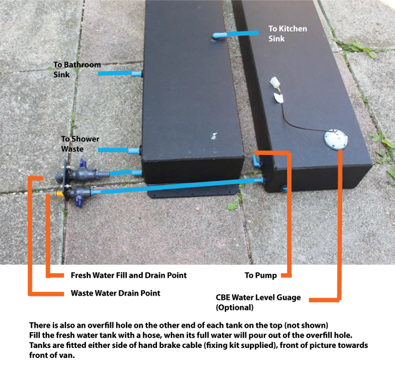

Sep 16, 2013
2,214
7,702
Horncastle, UK
28,132
Van Conversion
Since 2006
That's the Barratt Tanks fill/empty point.
You can add another filler to the top of the tank, but would need to remove the tank (easy job) and probably add an inspection hatch to the top as Barratt don't fit them as standard. You need the inspection hatch so you can get your hand in to bolt up the new fill point.
About the best tanks I've ever used by the way.

Sep 16, 2013
2,214
7,702
Horncastle, UK
28,132
Van Conversion
Since 2006
Deffo for draining Just smiffy there will be a filler cap somewhere, exactly the same as ours that setup 👍
Maybe Vantage spec the tanks with a fill point Paul, but as standard, the tap at the bottom is to fill and drain the fresh water.
I used to have the same in my own van, plus fitted a few and worked on other vans that have been fitted by Barratt.
Edit: An image from 10 years ago when I fitted my own van showing the whole system:
That’s the one….👍🏼😎
