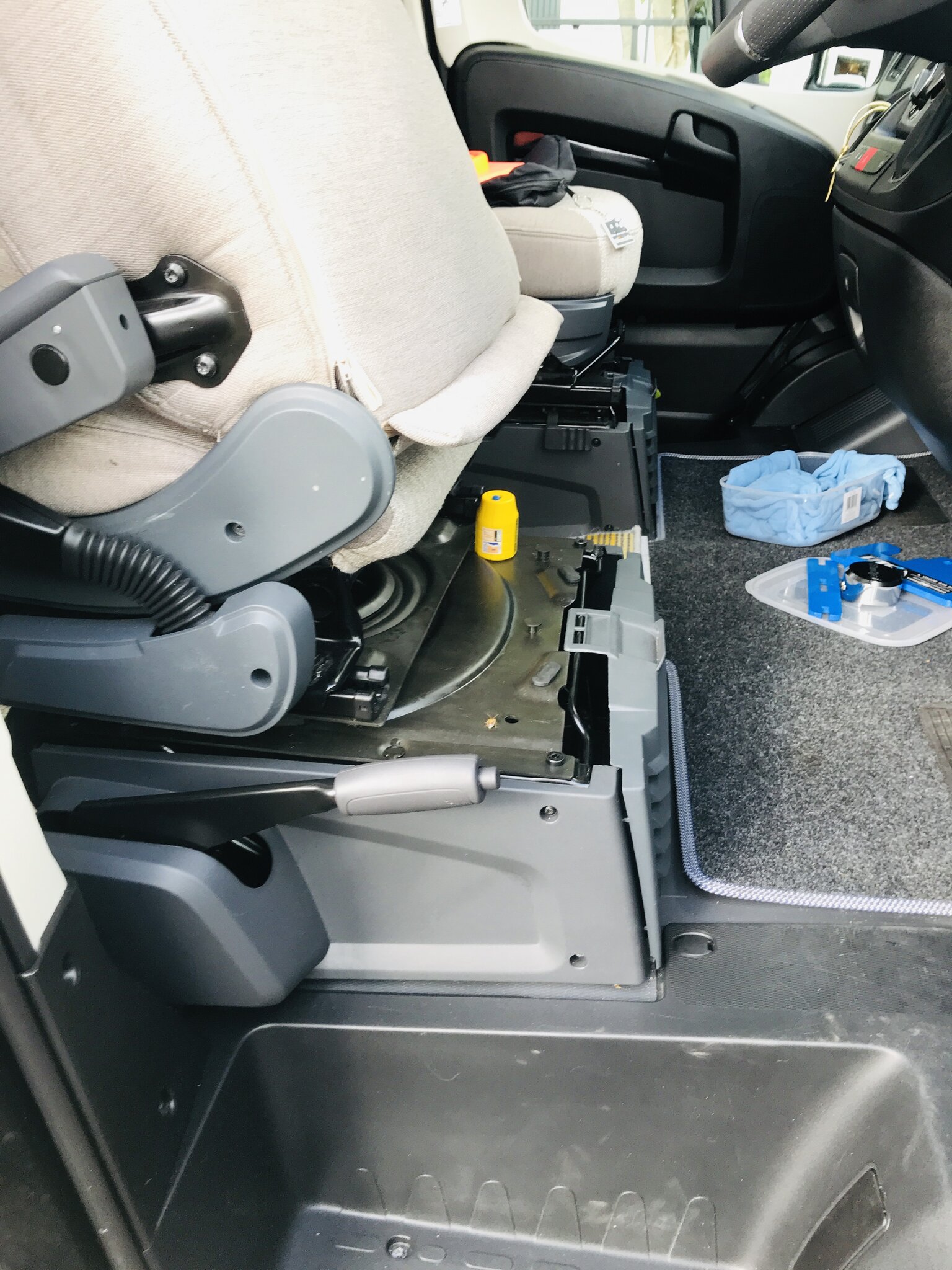

Clutch claw and Patriot motorcycle disc lock to lock drivers seat rotated backwards , plus tracker and alarm.
