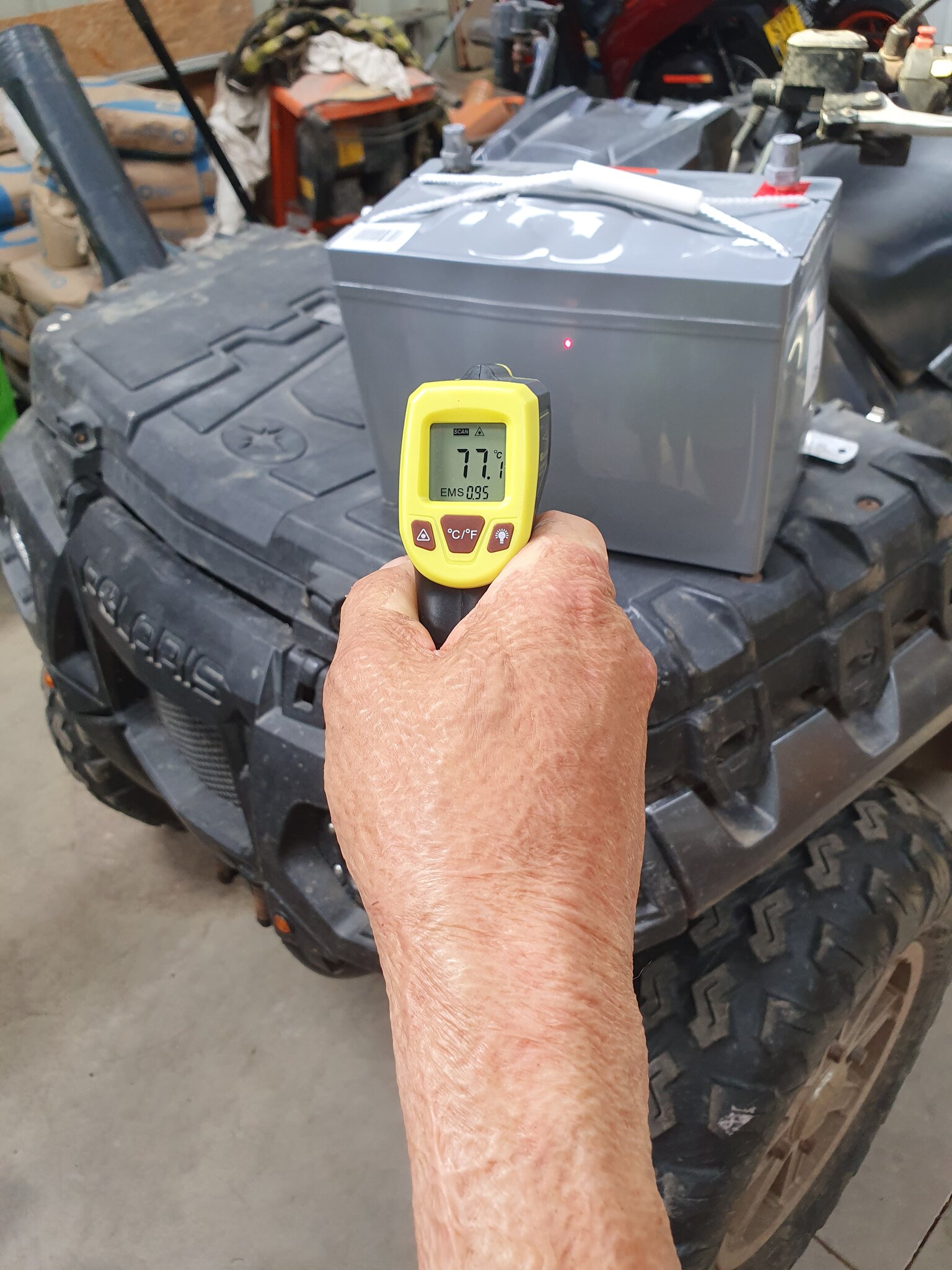

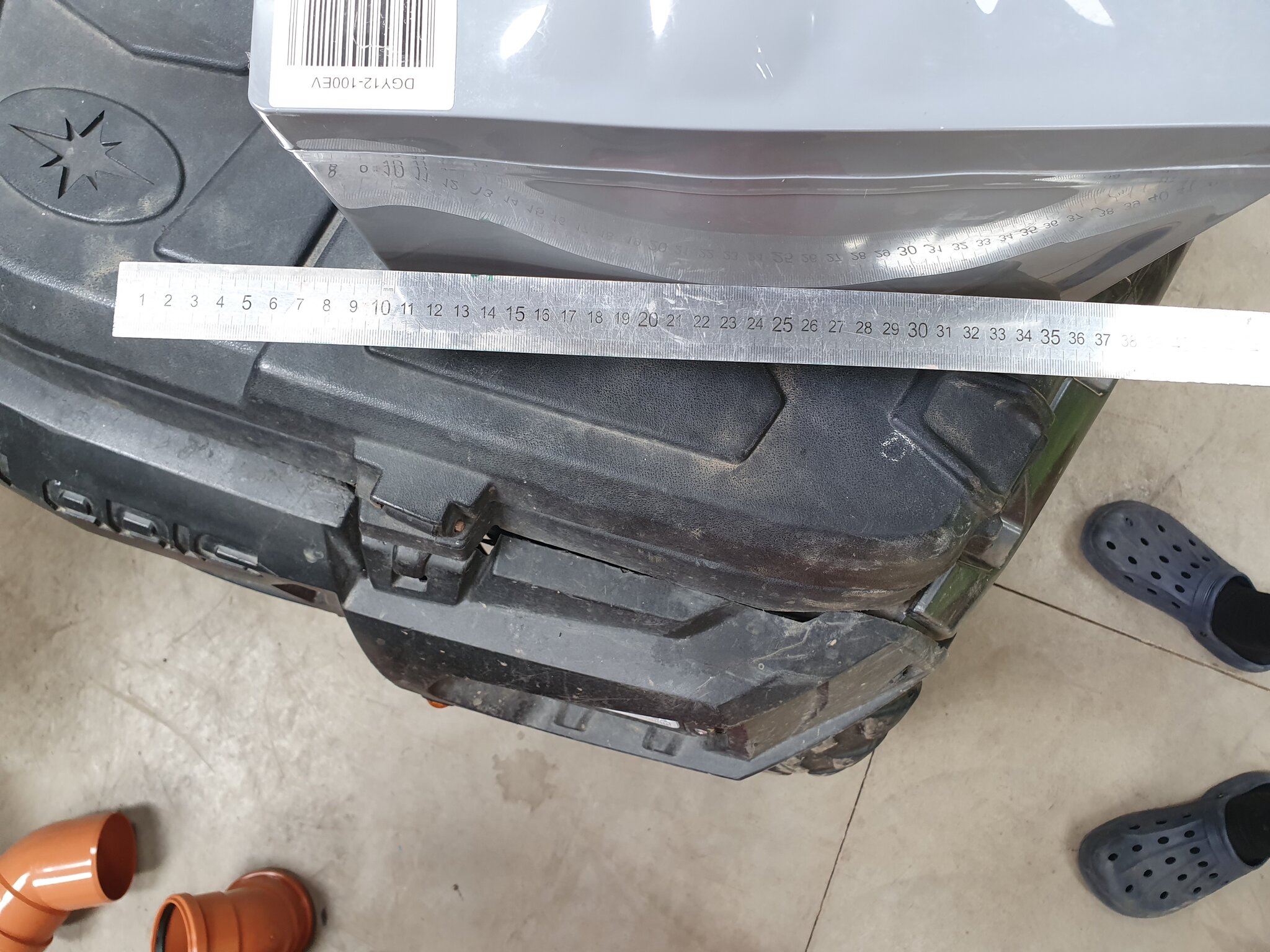

View attachment 667539View attachment 667540View attachment 667542
This particular one is definitely overcharging, either by to high absorb voltage, to much absorb time or to high charge rate. The gel batteries should receive a charge regime under gassing threshold. This one it bulged by the amount of gassing and it’s not meant to. The weakest link gave up.
