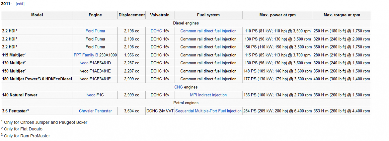

Variants of engines listed in wiki .. this is 2011 on http://en.wikipedia.org/wiki/Fiat_Ducato
Jan 28, 2008
9,946
17,640
Dovercourt, Harwich, UK
1,353
Renalt burstner
7 years campers before that
basic answer to your qurstion is no the fiat engines are actually ivecos and the citroen peugots are ford the 3 litrs fiats are also iveco

Wikipedia is slightly out of date concerning future developments. Diesel engines for Peugeot, Citroen and Ford have been made at the PSA plant in Tremery (Lorraine) for several years as part of a joint working agreement. However, in 2012 PSA announced the end of that agreement for larger diesel engines which they will now develop separately. The change will hit the marketplace any time now.
Ford and PSA/Peugeot-Citroen have announced that their collaboration on large diesel motors will cease. Both companies were quick to state that the move was not influenced by the French automaker's recent alliance with Ford's arch-rival, General Motors.
A joint Ford-PSA statement said the two automakers "have decided to independently develop and manufacture their larger diesel engines (2.0-liter and above) to meet their future needs as well as new regulations." Diesel mills of that size that were jointly developed by Ford and PSA are currently used in a wide variety of their European offerings, and it won't be until after 2015 that the companies will begin to offer independently-developed motors.
Ford and PSA will continue their partnership on 1.4-liter to 1.6-liter diesels, which have constituted more than three quarters of the more than 20 million engines the companies have jointly built over the last 12 years.
So that includes engines for the van range.
Also, the PSA factory at Metz produces gearboxes for the Boxer / Jumper and the Ducato - all of which are made in Italy at the SEVEL Sud factory.
According to the PSA corporate site, the new agreement with GM will include joint development of light commercial vehicles but it is not clear whether that is for car-derived vans or the larger Boxer size.
The first vehicles from this collaboration will be launched in 2016.
