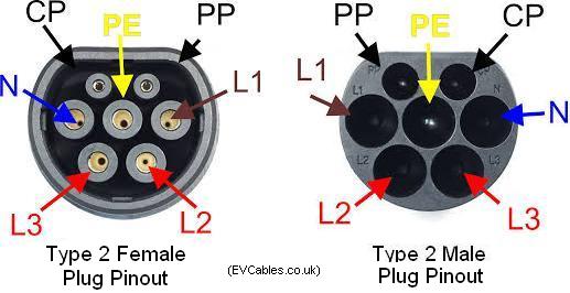

It's not simple but it's not very difficult either. As LesW says, there are many different charging connections. Some are standard 230V AC, some are AC 3-phase, some are DC at various voltages, and some are even AC and DC combined in one connector.
The 'Type 2' connector, also called the Mennekes connector, is a European standard, and is common throughout UK and Europe. It has seven pins, five high-current and two signal.
The five high-current pins are Earth, Neutral and three lives, L1, L2 and L3. The two signal pins are Proximity Pilot and Control Pilot.
Earth, Neutral and Live1 correspond exactly to a standard house supply. The charge point is designed to supply over these connections as one of its charging modes. There are two power level capabilities. Some can only supply 3.5kW per phase, but most can supply 7kW per phase. Note that 3.5kW is about 15A at 230V, and about 290A at 12V. So it's unlikely a standard, or even an upgraded motorhome mains charger will over-stress even the lowest 3.5kW supply.
The charge point will not switch on unless it has satisfactory Proximity and Control signals. These are designed for foolproof safety and to communicate the charge point and vehicle charger capabilities, so that neither are overstressed.
The Proximity signal tells the charger that a suitable cable is connected, and what power it will take. There is a resistor with a specific value built into the cable to provide this information, so that for example a thin 3.5kW cable isn't used to charge a 7kW vehicle.
The Control signal is more complicated. The charger puts out a 1 kHz square wave that flips between
+12V and -12V. A specific resistor value in the vehicle will drop the voltage to various levels, like 9V, 6V and 3V. This is used by the vehicle to tell the charger what power is it capable of using.
The charge point varies the square wave width (Mark-Space Ratio) to indicate what power it is capable of supplying. Because the motorhome charger is more than happy with the lowest possible charge point power level of 3.5kW, it can be safely ignored for this application.
Then later, when power levels are sorted out, the Control signal is used to tell the charge point to start and stop the charging process. This means a different resistor value is switched in. The charge point then locks the connectors so they can't be removed by a casual passerby.
When the batteries are full, or the user decides to stop charging, the Control signal must be switched to tell the charge point to turn off and unlock the connectors. Then the cable can be removed.
