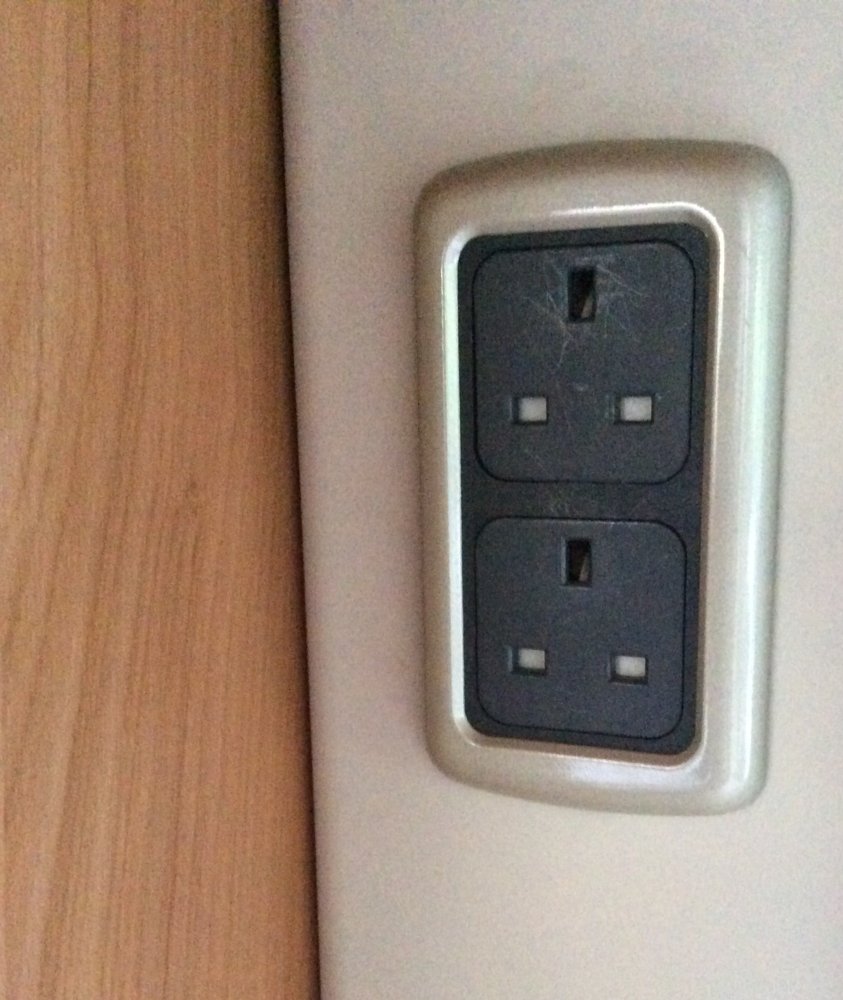

    image.jpeg If you do double them up I would advise against putting them this way around like they are in my Autocruise Alto. Quite difficult to get a second plug in! Am temped to rotate them around by 90 degrees if it doesn't look too odd.

    You could just rotate the top one and use it for chargers

    Who thought up that stupid socket idea? If your kitchen area is to the right i think sideways they will be moved to.

    We have a single socket like that which I turned upside-down. Very easy to do and the only way the Dyson charger would fit. You might be able to turn them through 90 degrees instead.

    When we had additional sockets added to the rear of the hab area, we told the dealer the likely use for them and they rotated them which ever way we wanted to accomodate the ridged charger plugs and whether the leads came off the top, the bottom or sides of the plug.

    That's exactly what I've done, rotated
    thats just what I've done, rotated the top socket 90'. It doesn't look odd and the array works quite well :)

    Rated two sockets 90 degrees. And yes was easy to do, thanks. image.jpeg image.jpeg
