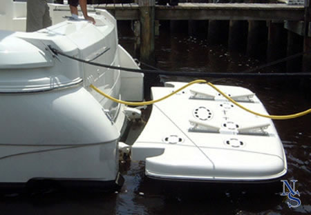

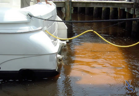

I have an equivalent hydraulic lift on the rear swim platform of the boat, with a 1,000 lbs capacity. IIRC that was a $40,000 option. I use it to raise/lower a dinghy or a jet ski. See photos. (This isn't my boat, but it has essentially the same lift mechanism.)
