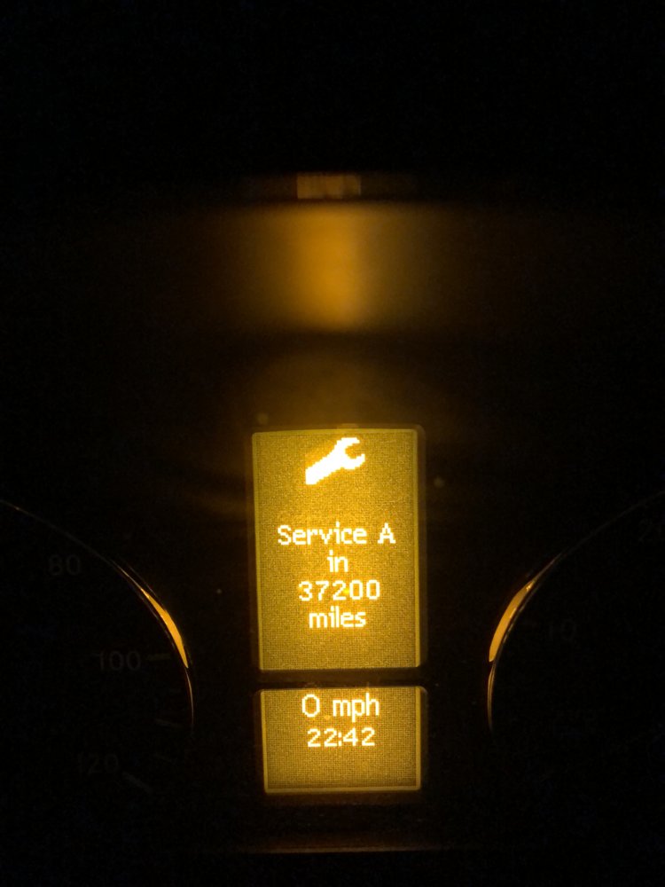

I am sorry that Mercedes forgot to consult your mechanic when they designed the Sprinter but here is what my service indicator currently shows. If the mileage has not been reached when it gets to about a month before 1 year 3 years etc it changes over to a day count and says service due in x days.
