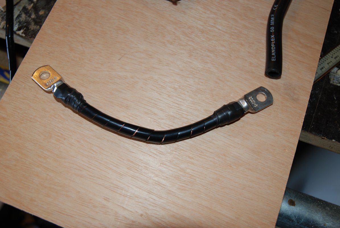

Pic 1 shows the old cable and the new before stripping. You can see how several of the conductors in the old cable have broken.
Pic 2 Stripped
Pic 3 Spiral wrapped and taped at the ends
The one I fitted David is like yours in fig 1 thats been on about 3yrs still ok, hope you notice a difference when starting,
Eric
