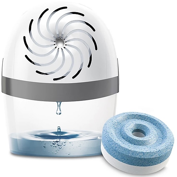

Had this in the van for 10 years now and it’s brilliant and well recommended.
Its not a fast electric clear system, but removes loads of moisture, especially in the winter.
As PP Bear as put it...we too use these and find them brilliant. Cheap to have and just amazes me how much moisture they pull out?
kev (y) ;)
Why does it amaze you? There is a plentiful supply of water in the atmosphere. :LOL:
A bit of science puts it into perspective though. At 10 degrees C, every cubic metre of air will hold just under 10gm of water. Lets assume the inside of the motorhome is 2 metres wide, 2.5 metres high and 6 metres long. That's 30 cubic metres of air, each one holding 10gm of water making 300gm, or 300ml, just over a mug full. Dehumidifiers do not remove all the water vapour, therefore you would be lucky to get 150ml of water in your dehumidifier, or about half a mug full.
If you pull more water than that out, it simply proves you are trying to dry the atmosphere.
This is a good post. I can only add that I agree with those that say if the van is not leaking anywhere, there should be no excess moisture in the air and no need to dehumidify it.
Never used one and never had a problem. Electric is going up, so unless you have a specific problem save your money.
