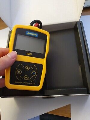

This is a very handy tool for evaluating your starter battery and charging system, also a failed diode in your alternator may be the cause of parasitic drain.
