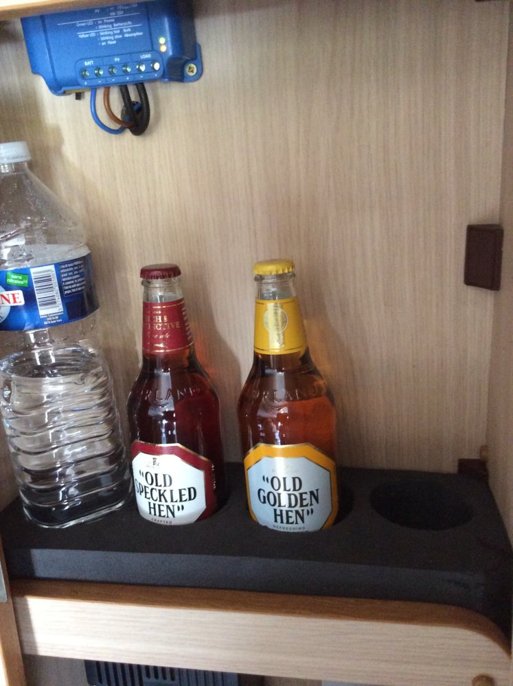

I was trying to model mine on the one you can buy ready made like @peterc10 linked to. However as you can see my cupboard not very deep. I tried to find the layered foam used in that video but I couldn’t find it in UK.
The black high density foam looks good, no crumbly edges and most importantly no rattles in the cupboard which is just behind driver’s head so would be annoying.

Looks very neat and professional.

I realise now that I’ve been calling it high density foam, however that’s not the right stuff. It’s called closed cell foam and I bought 2 bits cut roughly to the size of the shelf, one to play with and one for final result.

Not particularly cheap but does the job well. I also bought some 4 in thick dense cushion foam while I was at it but that was useless for bottles.
