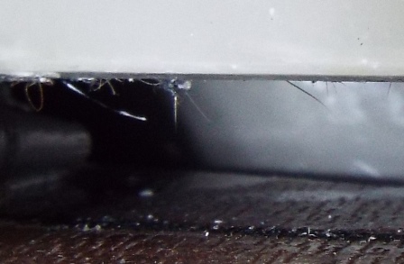

Pictures B to E - Cracks
These show the actual cracks themselves:
  • B - Crack 1 closeup
  • C - Crack 1 with light underneath to show nothing underneath to block light
  • D - Crack 2 closeup
  • E - Crack 3 closeup

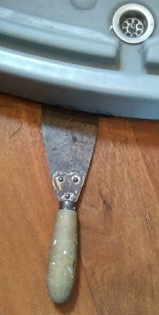

I was able to push a very large scraper under the shower tray and there was nothing at all preventing this, these pictures show the scraper etc (ignore the white stuff, it's just some bits of the sealant I'd put under the tray to try to support it and stop the cracks getting worse):
  • F - Scraper above tray
  • G - Scraper next to tray
  • H - Scraper under tray
Pictures I & J - Under tray
These show under the tray as far as I dare lift it - you can clearly see that there is no support whatsoever on the front or under the water channel where crack 1 is:
  • I - Under tray to right of crack 1 - the wood on the right stops where the spiral tambour door sits
  • J - Under tray to right of crack 1 - close up of channel on left (black hole!).
I told him that I've corresponded with a chap on the Possl forum and he's had TWO trays replaced to date for the same type of problem so I'm not the only one who's had issues. I also sent him video clips from YouTube: the first one is the start of the video, the second starts where you can see the 'flat' base below the tray and the third starts when the wooden surround is put in.
I've said that I think he'll agree with me that this has to be a design/build fault as there's no way that this tray, without support, could be expected to last and the shower is totally unusable now, even using the toilet is tricky as we daren't close off the compartment with the tambour doors! I've asked what his next 'action plan' is.
