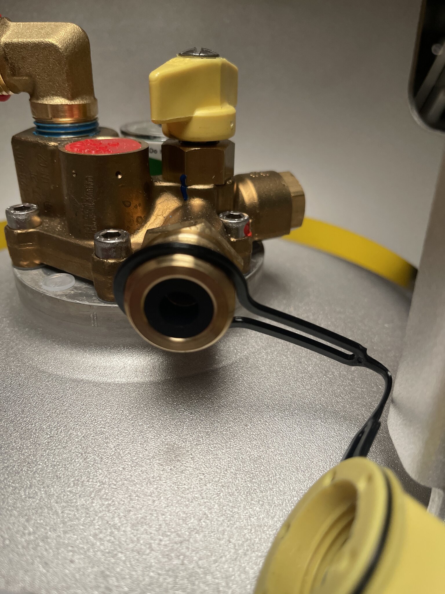

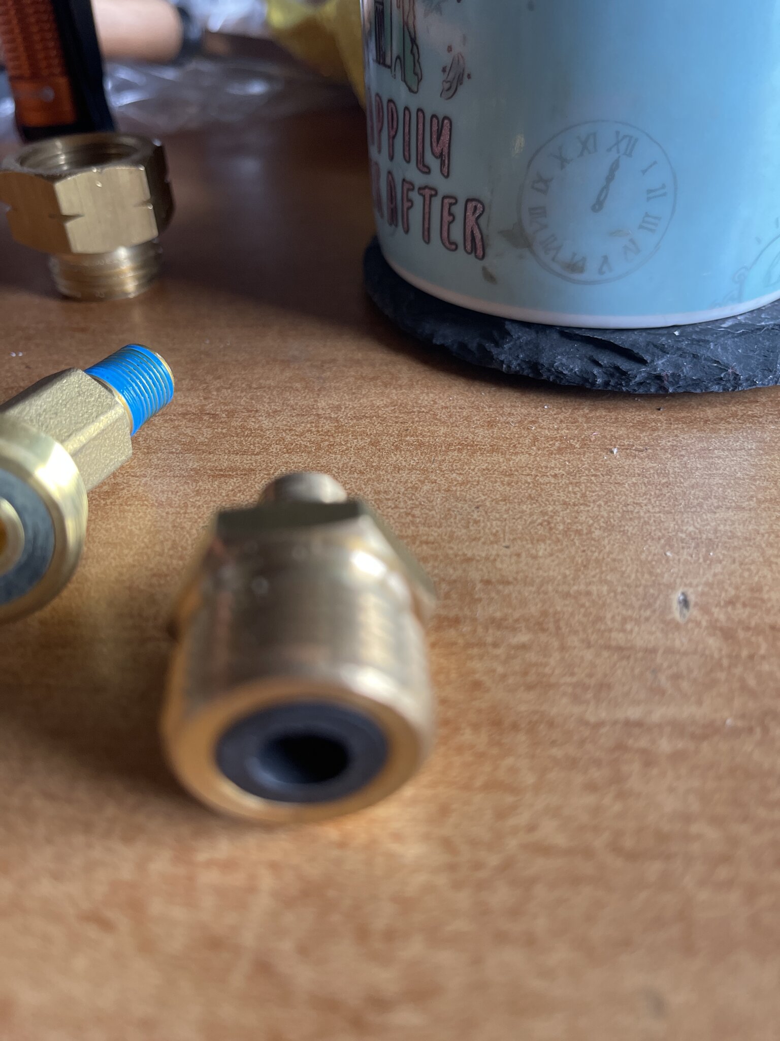

Some of the older Alugas cylinders actually required the German style pigtails.
Can you tell us when they changed & the difference please?
They look like mine (2014) I thought they were the same thread as UK butane.
The first picture is the newer type adaptor which uses a standard 21.8lh Butane type connection
Two middle ones are both German type hose adaptors with no rubber washer on the pigtails.
Last adaptor is Gaslow type the same as the newer Alugas.
Date of change was probably around 2015
