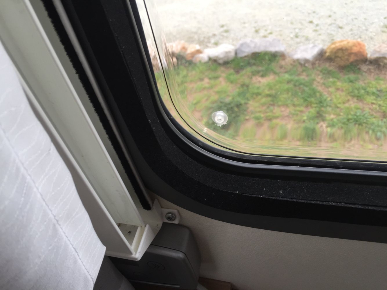

This is a cure that I did on an aluminium window frame it’s hatch seal tape , easily removed when needed to replace etc working 100%.
