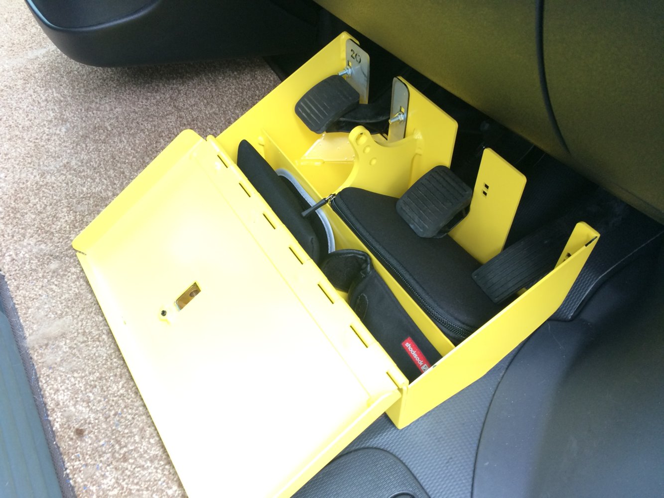

I am not at home on my laptop right now or i would post a link to a pedal box sold by garrison locks. Very secure and substantial

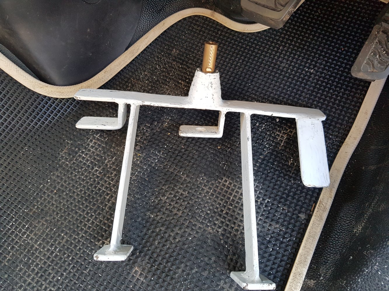

Hi.. heres a picture of the sort of thing i made up for a ford transit... the one debs got was a bit different... it didnt need the legs..
They are easy enough to make if you have access to welding and drilling facilities..
I use a roller shutter door lock welded on to some flat bar..
They are not as bulky and heavy as most of the commercially available units... bit mine is easily stored in the door pocket..
Andy
And fitted over the pedals
I was thinking of something like the attached

PedalBox is about the best, as above.
Not much point worrying about whether clutch claws or similar will resist an angle grinder when the pedal arms they're being fitted to are made of plastic!
The design of the PedalBox makes access to cut through the pedal arms much more difficult unless you were to remove the lower dash panel, but even then you would be left with stumpy little arms that would make driving the vehicle extremely difficult.
