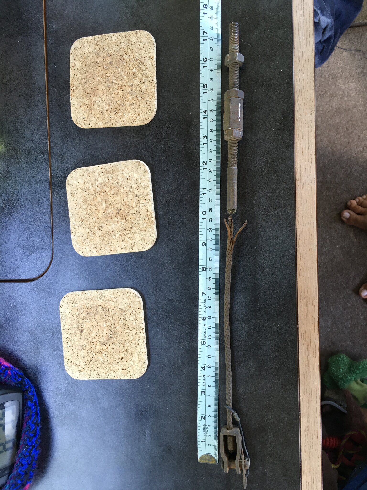

I’ve searched internet and phoned a couple of places with no luck.
Any suggestions of where I can get a cable like this.
I think you may have to get one made up, but from where I don’t know. How about trying kit car builders, hot rod builders etc. (y)
You could try a boat yard, they may help you
That looks like what is on our Armitage’s A frame. Why not try them or any trailer manufacturer who will need such things for their trailers.
Finally got sorted today with a brake cable , went to TAF chesterfield to see their A frames and he had some used parts on the self and had what I needed.

An overbraked system is where the tow hitch has a spring hidden under a rubber concertina cover. When the tow vehicle brakes, the trailer pushes and compresses the spring behind the hitch thus applying the brakes through the cable in the picture above and a Bowden cable between the front of the car and the brake pedal in the towed vehicle. In turn the brake pedal has to be sprung to return the pedal to its normal position otherwise the brakes would not free off when required.
