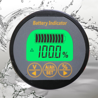

For a more permanent battery monitor
Above For lead only
Or victron smart shunt or bmv712
Above for lead or lithium
