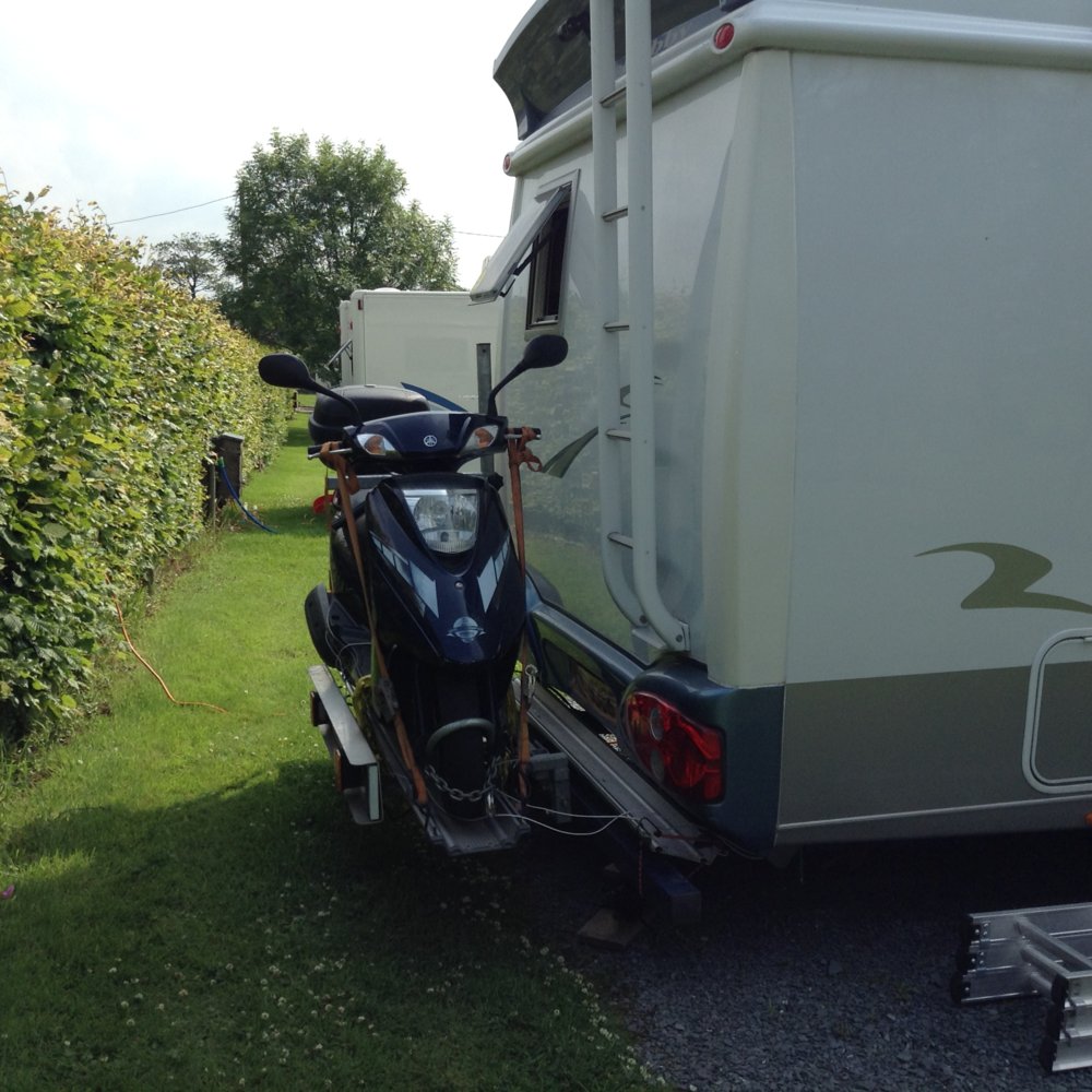

We had ours uprated by the farmer where we're staying. Took the bar off and strengthened it all up them put an Armitage rack on it.

Watling engineers at St Albans fitted our chassis rack £850+vat. Done a good job, all in one day.

Road pro do the identical rack to LNB It is a Memo Classic and has a locking wheel chock which holds the bike while you strap it. I asked LNB why there rack was 600pounds dearer that Road Pro They declined to comment. Unfortunately Road Pro have not sold any such racks But I have been in direct contact with Memo Europe based Netherlands, who answered my questions. Their chassis receivers will bolt directly onto the Alko Chassis provided that you have no tow bar fitted. I have a Factory Fit Sawiko but the receivers will be too wide for the standard rack.
I have a Watling tow bar rack which I am now looking to convert to fit to fabricated receivers.
