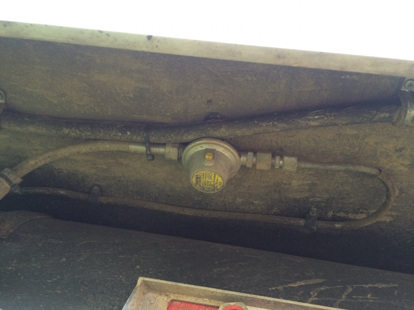

I took the cover off but nothing seemed very obvious (to me). There is something above that looks like a regulator so I've posted that too.

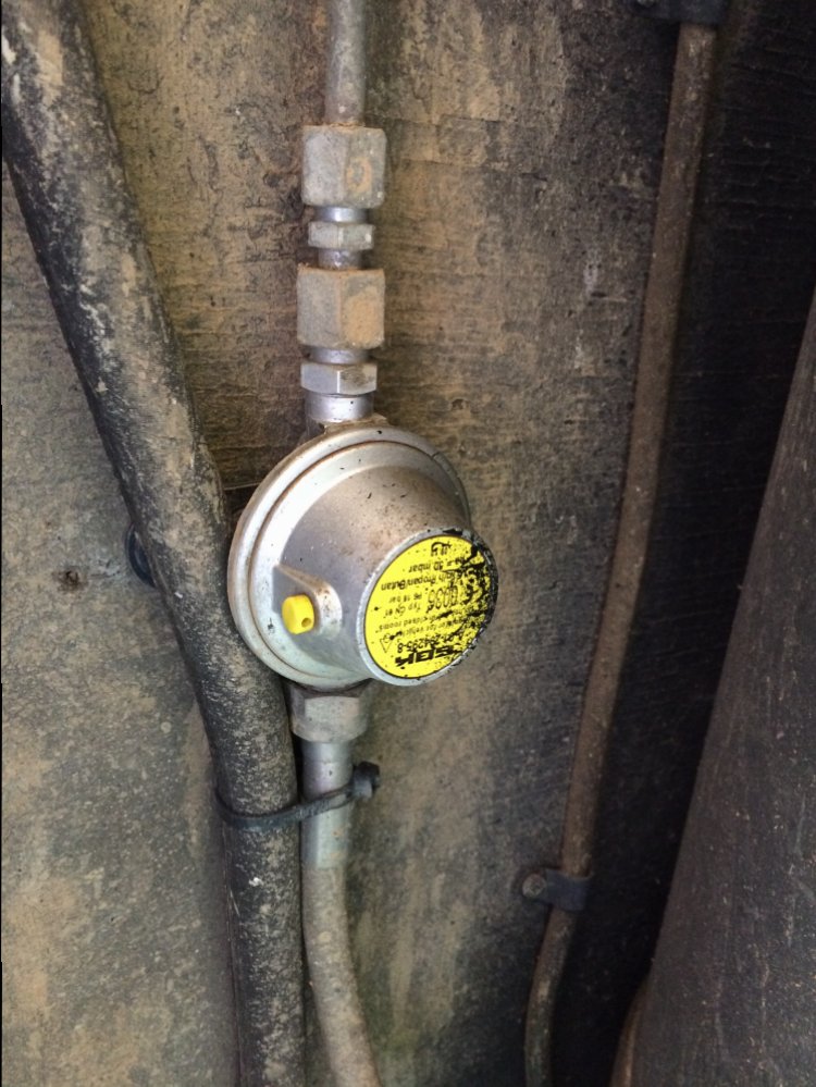

Yes the something above is the regulator. You need a close up of the yellow label (clean it first) and whether the gas pipe is 8mm or 10 mm

First picture is how it looks. Second shows label 'flipped' to make it easier to read.
