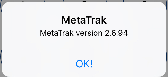

How do you know? Where does it give version number?
Ok I found it under Options, account profile. I have the same version 2.6.94
It also updated today. According to iPhone updates “bug fixed”

Mine is on android version 2.6.92.
Are both of yours apple?

Were the folk who had problems on Android or Apple...?
Edited:
My Android updated yesterday to 2.6.94
(Unspecified "bug fix" and I wonder what happened to version 2.6.93)
Just a coincidence?
Just a coincidence?
It is quite normal for software release versions not to follow incrementally. Intermediate versions may have been for internal testing.
The Metatrak app updates fairly regularly. I have my phone (Android) set to notify but not automatically download updates for all my apps, so that I can choose when to install them. I have been burned in the past with various "updates" that did not function as intended due to bugs that were not apparent until after release, so I prefer to let others be the guinea pigs now :)
Having said that, there was an update for the Metatrak app a while back that completely borked the tracking and location function. It was fixed by another release within hours though, so many customers may not have noticed.
I was stuck for nearly three weeks with a new version of the Victron Connect app that introduced an error into a particular reading from my battery monitor. Just at the time I wanted to use it too (Sod's Law). It was fixed in the next release, but annoying at the time nonetheless :(
