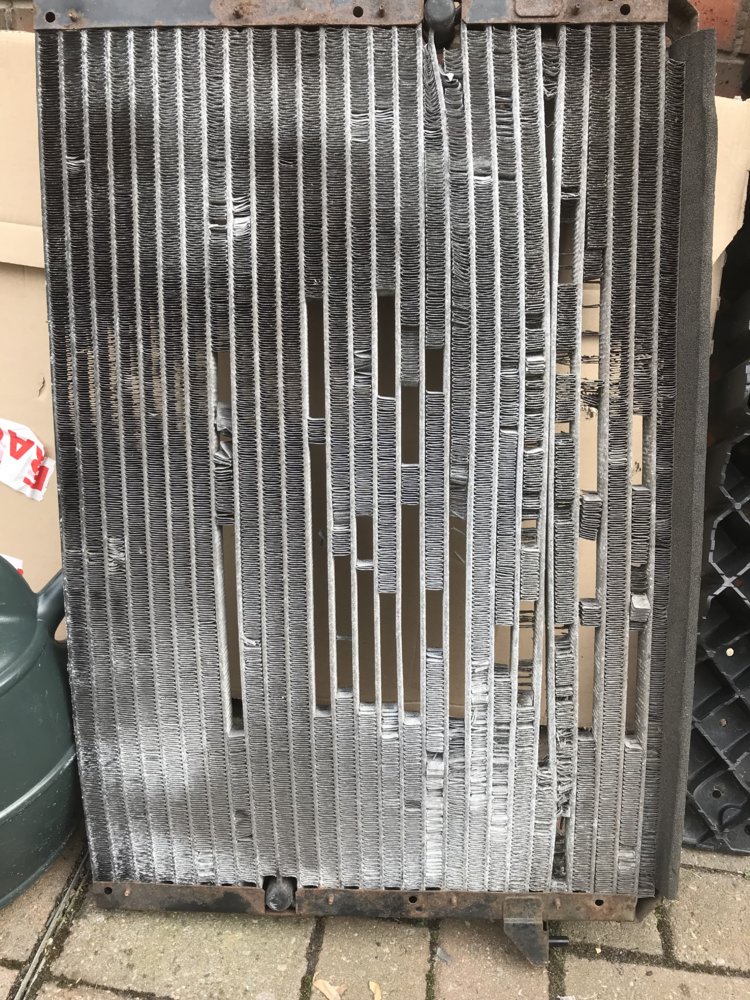

A Photo of a perished condenser. It's not leaking, just falling apart and lost its efficiency.
The car has never been recharged in 20 years and we reclaimed the refrigerant and re-used it, back in the same vehicle.
