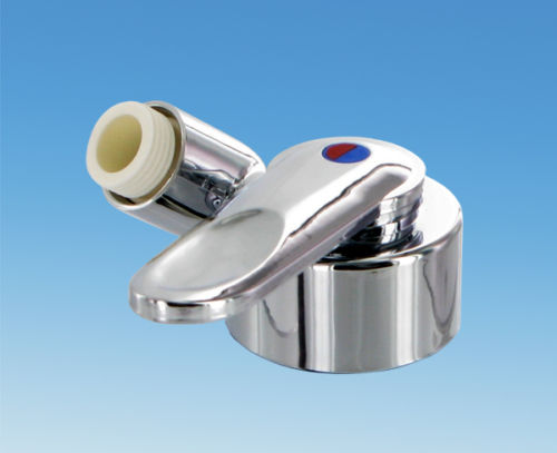

Well today I decided to try to get to the bottom of the shower leaking in our Burstner. We had been away last week and after every shower water was running onto the carpet and out underneath the van by the rear wheel arch.
Either its the shower tray/drain - nightmare to get that out. Or the shower mixer tap.
I'll thought i'd start with the tap. I simply ran the shower hose into the sink for 5 minutes - nothing!
Then noticed water seeping along the edge of the shower tray at the bottom of the plastic shower wall - walla.
It must be coming from the mixer tap. Bit of faff to remove the plastic shower wall board but eventually exposed the tap and it was leaking like a goodun when turned on, running down the back of the wall and through the back of the shower tray that not sealed to the wall.
Local caravan stockists had a very similar one for £45 - sorted.
