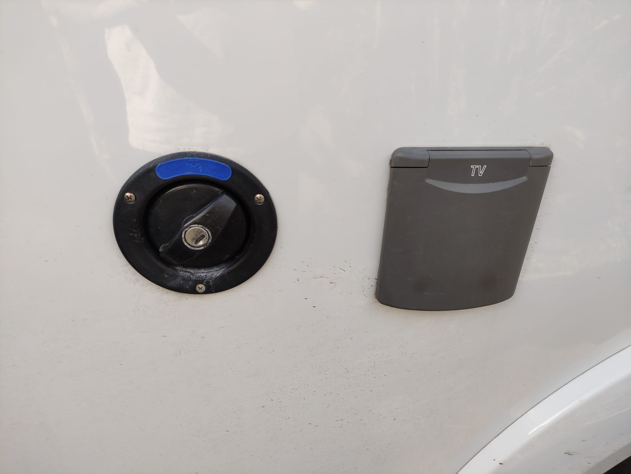

Water ingress check today (£178!!!) and not good news
They have detected 50% moisture levels in between the water fill point and the exterior TV cable socket/power. (2021 Burstner Lyseo 727G)
No obvious reason but the technician suspects water getting in around the TV point as this seems the only possibility. Apparently a whole section will need to be replaced as once the damp is in it will not dry out.
Sadly the dealer doing the check won't do a warranty repair because I didn't purchase from them. (I have had 2 damp checks done with them so it is disappointing they will not 'take me on'.
) They are local to me but my purchasing dealer is 100 miles away and I don't have a good relationship with them. I do not trust them at all.
Anyone have any thoughts on this issue or experience at getting a non supplying Burstner dealer to to take on a warranty repair?

What is the construction of the wall I would firstly look at.
So water has got in but they say it won’t dry out but continue to be wet?
Somewhere dry and warm, take off the tv point and water point and have a look. Could it have got in as the tank been filled with water, a fault/crack/loose fitting/pipe etc.?

There is no visual sign of damp. The TV point looks fine. If I took it out it would break any seal that is there. Then I would have voided the warranty.
Not sure on construction. I know the floor is grp and they don't damp check that. The roof did have an issue with a poor solar panel installation but that dried itself out which suggests they think the walls are constructed differently.
how would they know unless you are some sort of butcher? Why would it void a warranty? I'd expect to do anything i required as long as it was replaced equal to or better than it was when first fitted?

How have the checked it’s damp? Have you got a damp meter yourself to check, that would be my first job, or ask another Motorhomer to check for/with you?
Is there any evidence inside/outside of damp that you can see?

WOW!! Spoken to Camper UK after recommendations from other Burstner owners. They immediately said they would look at it and fix it under warranty if needed. The first positive interaction I have had a Burstner dealer in 2 years.
They were not impressed with my local dealer for refusing to do the work after taking my money for 2 ingress checks. A pity as I really wanted to have a local dealer I could go to for serivce over the coming years and now they have lost me. If Camper UK turn out ok and it means a long trip once a year then so be it!

Yes I agree with you, don’t ask them, could you get another opinion? camper UK have agreed to check it out anr repair if ness.
When people research which Motorhome to get and look at the wall/roof/floor construction etc etc then a lot of people, especially experienced motorhomers, would buy partly on that basis. must admit i didn't do any research!
The construction looks good on the link funflair put up so why then would it require a section removing? Unless it’s warped/delaminated etc
How have the checked it’s damp? Have you got a damp meter yourself to check, that would be my first job, or ask another Motorhomer to check for/with you? I don't have a damp meter
Is there any evidence inside/outside of damp that you can see? No sign of anything untoward.
