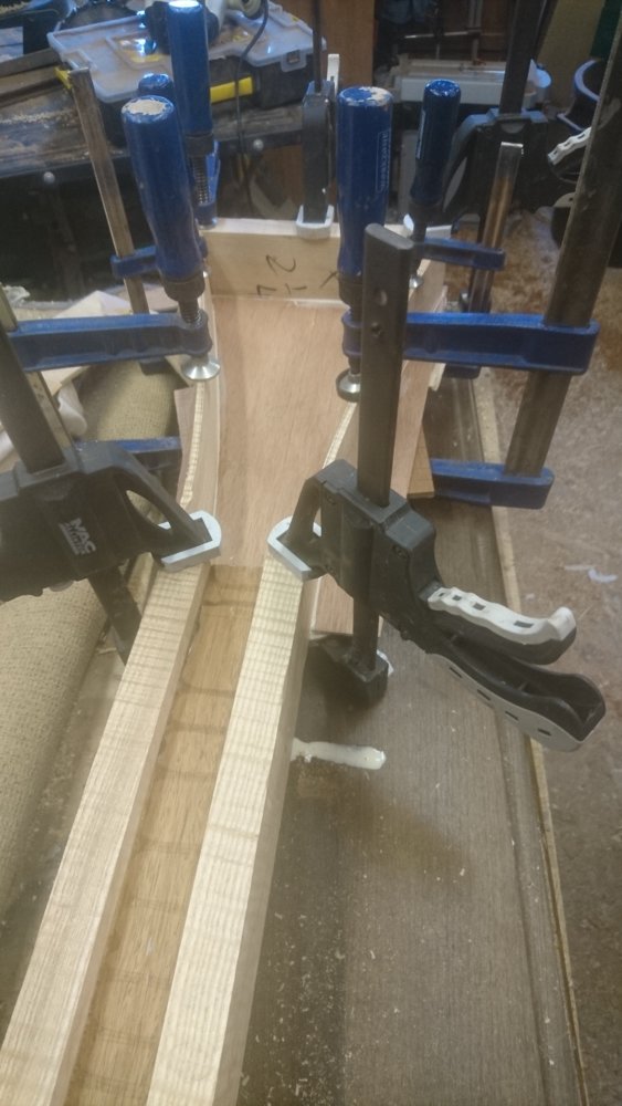

Decided to have a go at building an acoustic guitar. I normally build electric guitars and basses so this was a departure from the normal. Start small I thought so decided to copy a Martin Backpacker....
Started with 70mm square of Ash. Decided it was too thin so added 25mm of mahogany.
Glueing the top on.....
Looking like a guitar....sound hole to cut once I get an 84mm holesaw!
