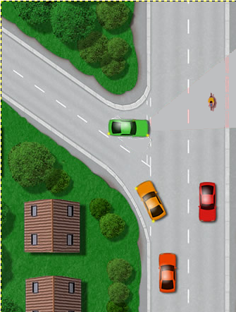

In your diagram, if you are the green car. Keep to the centre line and, at the last minute, turn the steering sharp left so that the front of your vehicle is square on to the junction, not at an angle.
This will allow you to see traffic from both directions just as you can do at a normal T junction!
If its at a more acute angle, buy a bullet spot mirror or Fresnal lens.

This is how I handle these types of junctions. Excuse my abysmal editing skills.
I stick to the central white lines as I approach the junction and at the last minute swing across so I am at 90Ā° to the junction.
That's what I was waiting to the end to say, 10 years of driving vans, it's what I do instinctively,even on straight corners I always try to get the drivers side farther out.

As per the above little green car.

But my car isn't green, so I am utterly confused :unsure: :unsure: :unsure:
Geoff
We can rectify that, let us just know what rally your attending. I've got some old green paint in the garage.
You know us Funsters always want to help! :LOL:
