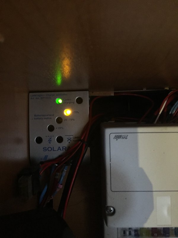

Does it (the B2B unit look like this?)
I'm trying to work out whether my solar is keeping the starter battery topped up.

If what I am seeing is a module with a massive bunch of wires connected is what you refer to.. It is certainly not like any B 2 B unit I have ever seen !
But I have not seen 'em all :)
More usually there are just three or four wires going to it.
Is there anything printed on the module ?

That just looks like a standard Fiat engine battery installation in the passenger seat footwell. If your van is standard as bought new you probably haven't got one. Do you have a button on your control panel to select charging the engine battery instead of the habitation batteries? You have not given the make and model of your van which would no doubt help someone on here advise you.

Sorry it is a Rapido A class (9010df)
No switch that you refer to on the control panel but it does have a few 'extras'. I'll take a pic of what I believe to be some kind of battery master later.

Didn't get to the battery as need to shoot out but did take a pic of this (sorry it is installed upside does). It says CAC computer automatic charger. I also have another thing next to it which I assume shows the solar power in operation.

Hopefully an experienced Rapido user will be along in a minute to explain what you get as standard on a new Rapido van and how it all works. I fully admit to not having a clue what they do in their vans.

@Jaws got to the module and it reads jaeger trailer module. I'm pretty sure I don't have anything topping up the starter battery as it has now dipped to 11.4v and is flashing on the panel. Pic of module below.

Here is a pic of what was hidden beneath the cover of the battery. What is everything doing there?

View attachment 62938 @Jaws got to the module and it reads jaeger trailer module. I'm pretty sure I don't have anything topping up the starter battery as it has now dipped to 11.4v and is flashing on the panel. Pic of module below.
That is a canbus bypass relay module for trailer lighting.
Stops the vehicle canbus system from realising there are extra lights and throwing up lighting faults.
