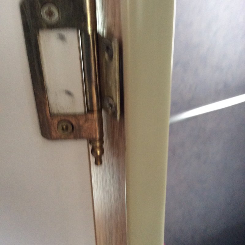

Can you post a picture of the door and hinge area? I would be surprised if the door was hollow where the hinge is.
Here are photos. Sounds hollow though.
If the screws only have a thin ply to go into, this problem will only recur..
I'd be looking at fitting a full length brass piano type hinge ..

From pics it looks like you can drill right through the wall. If this is the case then do it and fit bolts with washers or a plate with holes drilled.
You can get countersunk bolts and spring washers for hinge side.
