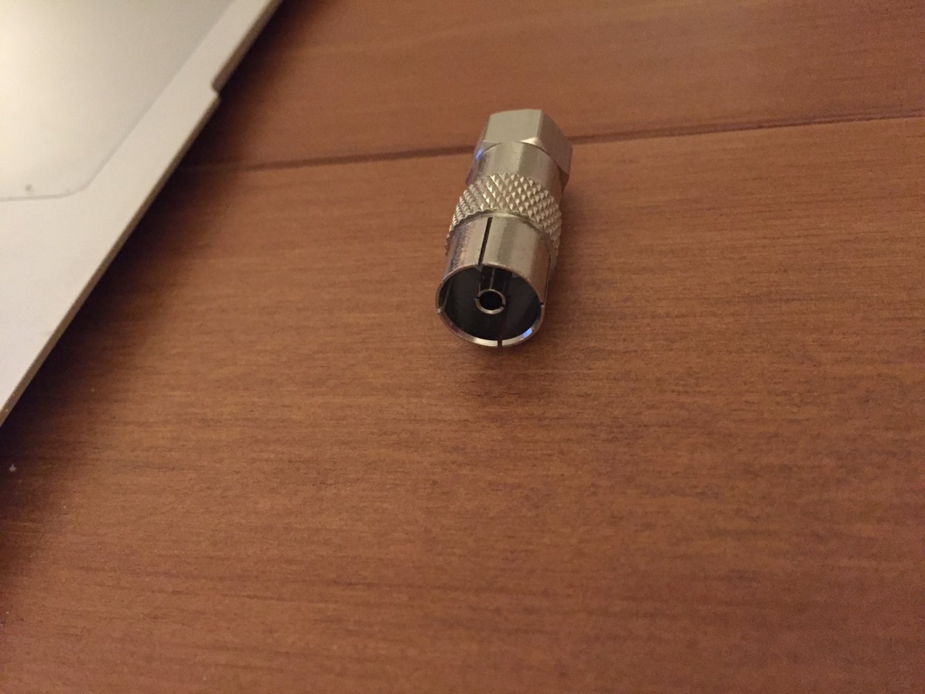

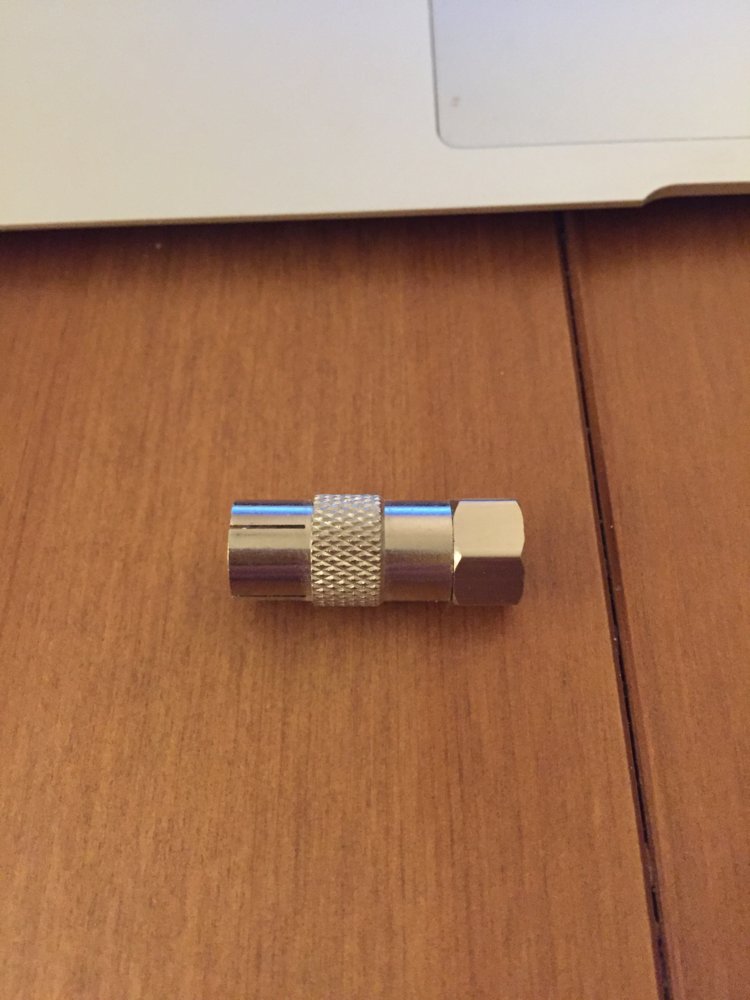

I called Jacksons earlier (who supplied the tv) and he suggested using the coax cable with an adapter into the Sat in.
I've got the adapter now as per your photo so will give this a try and will do a search in satellite mode.

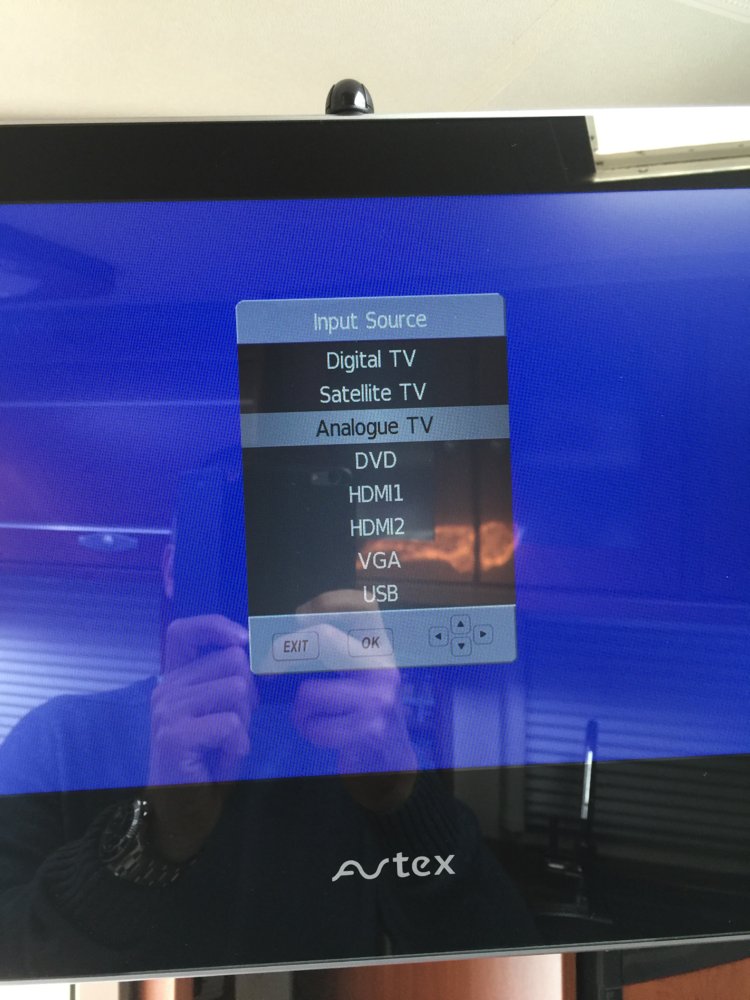

Question for you - how do I put the TV in analogue mode?
As far as I can remember, the source button showed DTV, Satellite, DVD, HDMI1, HDMI2 and USB.

I don't have the option for Analogue TV in the menu when pressing the source button.
Will show you when I'm up there

No analogue tv option.
Just plugged coax with adapter into sat in and done search in DTV and satellite options and it's not picked up anything.
Plugged into RF in and done search in DTV and satellite mode/options and again it's not picked up anything on doing an auto search.
For whatever reason it doesn't allow a search when in AV mode.
