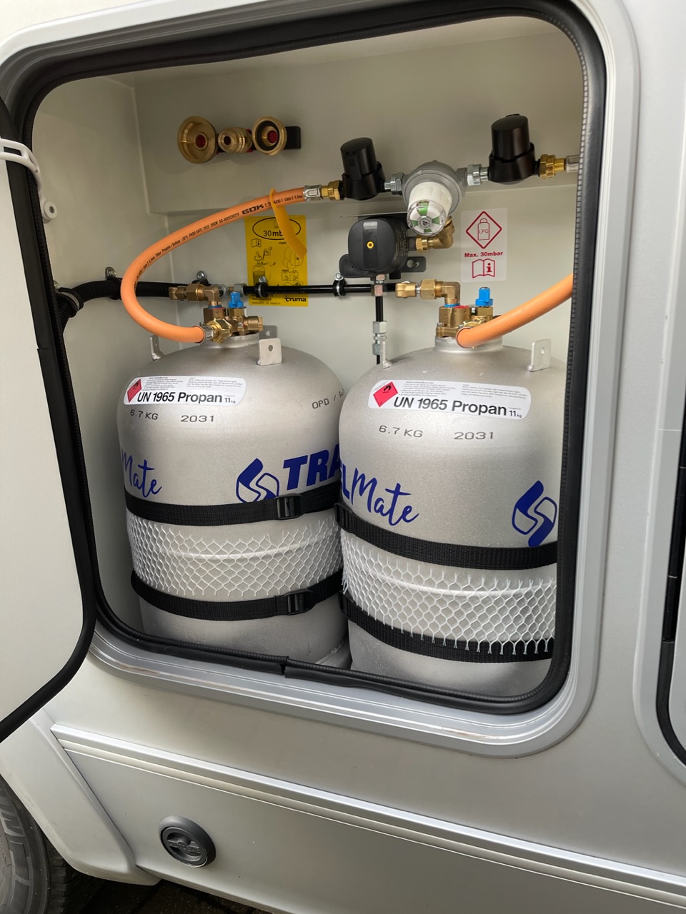

Yes, that would be a good starting point. My twin 11kg Alugas system was a fair bit below that but only as I carried out the installation and commissioning myself.

Nice neat install, but no crash sensing? and are those 11kg bottles?
Thanks, yes 11kg, I could have possibly squeezed 14kg ones in but at the time there was a shortage of all sizes, so I took what I could and got a cracking deal on them anyway. No need for crash sensing pigtails with the Multivalve on the Alugas cylinders - from the website:
“The Alugas MV cylinder also incorporates in the gas off take valve a rupture protection (excess flow device) as a further safety feature which replaces the need for special “rupture protection” pigtails with this valve fitted to them. This allows for safe travel with gas turned on and, in some cases, where allowed, operate the vehicles heating while driving.”
