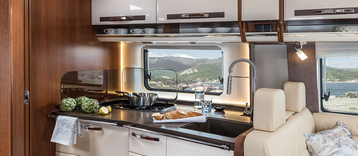

It's very similar to the picture but with updated tap and sink layout. Fortunately, the removal of the drawer gives reasonable access. It will still be a real pain to do. But better option than drilling and fitting another tap.

When you fit the new tap make sure you put the tails into its base before attaching it to the worktop ... it is a LOT easier!!! Just make sure you have all the tap base fastening bits (washer, plastic nut etc) on the pipes before you fasten them all up as you won't be able to slot them on afterwards ... don't ask how I know! :rolleyes:

MORELO really are so helpful. I e-mailed the helpline and they have just got back informing me that the tap can be accessed by removing the cushion on the lounge seat and their is an access hatch secured by Velcro which allow clear access to the tap between the two sinks. They really are good at paying close attention to detail.
Just the plumbing to worry about now :unsure:
