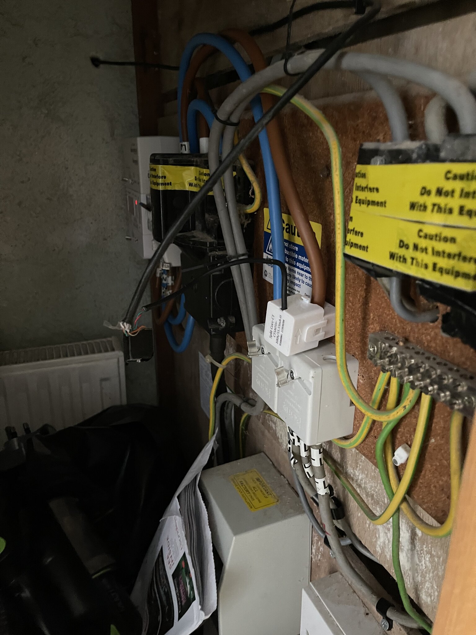

As you can see the finesse of the installlation

Yes, that looks like a CT clamp on the brown wire. If the brown wire with the clamp on goes straight to the meter when you follow it (in the direction of the arrow on the clamp) upwards then the CT clamp is in the right place and the right way round I think.
The wiring from the clamp looks a bit iffy mind you...
If you can get to this screen on the inverter then you can test that the clamp is working as it should
This shows ours, with the power coming from the grid currently at 653 W (importing).
When the battery is flat, get to this screen, you will see (hopefully) the amount of power you are drawing from the grid as a negative number. Maybe -300W. Then turn the kettle on and go look again - it should change to maybe -2500W or even -3000W as it registers the power drawn by the kettle being imported from the grid. The value should change within a few seconds of the kettle going on and should go back again just as quickly once the kettle is turned off.
You should rarely see this number go far positive (as that would mean you are exporting power). The exceptions are
*) When the batteries are full and the solar panels are still generating
*) When the batteries are being charged at their maximum rate and the solar power exceeds this rate
*) For a few seconds at a time if the solar output or power used by the house changes - until the system regains balance
*) Small amounts (<100W) - the system may not activate the battery charger if there is only a small amount of excess power as trying to charge with 40W available might mean 30W gets used running the charger and 10W goes into the battery - not worth it.
Note that if the battery gets cold, it will not charge as fast as if it is warm, so if you get a lot of sunlight on a cold day and the battery is outside or in an unheated garage, it may not charge very fast. In fact, if the battery goes below freezing it will not charge at all, as charging below freezing can damage Lithium batteries.

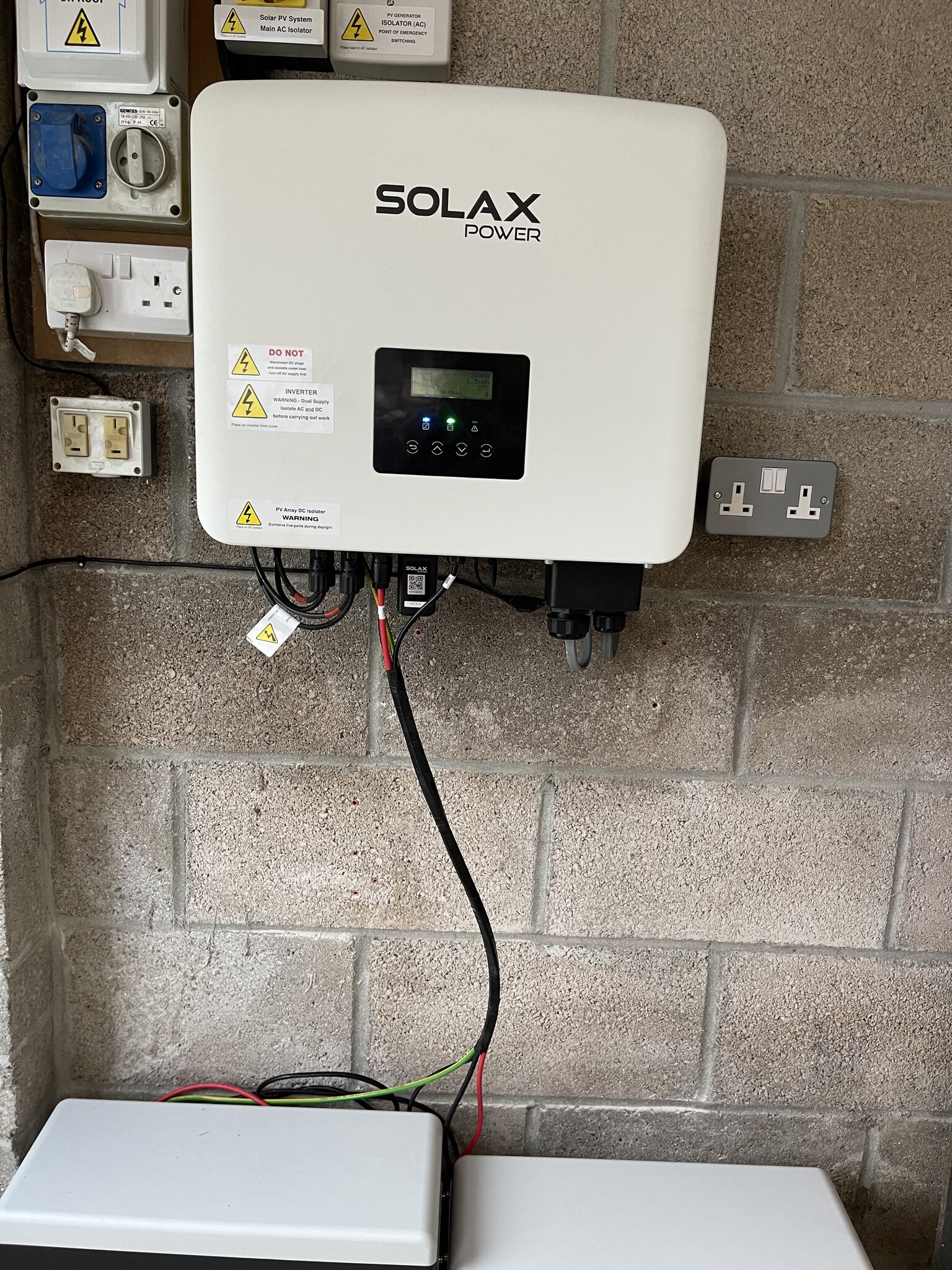

to say the whole set up is poorly installed this is how the batteries are placed so much for a professional installation.

Certainly a bit messy on the wiring front. Surely they could have managed a few clips to hold everything to the wall nice and tidy!
Our batteries are outside and have all the cables protected by corrugated plastic pipe (which is actually recommended in the Solax battery install guide).
I keep meaning to put together a bit of a shelter to keep the worst of the weather (and the leaves) off them. Expect I will get round to it by about springtime!
