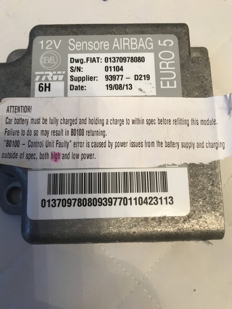

Last year airbag light came on on the way to MOT. Went off when I stopped and restarted engine prior to MOT. Stayed off from March to August when it came back on and stayed on. Removed and sent to Crash Data. Just got it back ready to re-fit prior to MOT. I noticed the part had a date 18 months AFTER original vehicle registration. 2012. I contacted the previous owner who told me the original module failed just after warranty expired.

Mine has a different part number as well as a later date 26/11/16 that corresponds with the likely build date of the base vehicle. If FIAT kept changing the part number over the years, (there is a long list of the module part numbers on one of the CrashData web pages) how come FIAT hasn't solved this voltage sensitivity problem by now? Is it because it mainly affects only motorhomes not delivery vans? Given that the number of MHs affected is in the thousands I'm not surprised that replacement airbag ECU modules are in short supply.
