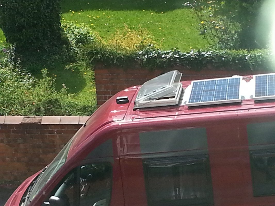

Our low profile roof mounted antenna has a full fitting kit - so you just drill a 25mm hole through the roof of the van and the whole thing self-seals just like a status. This antenna is available in black or white.
A black one in situ. Lousy picture quality I'm afraid.
Installed by Dave Newell's chaps at the same time as they did the solar panels also visible.
