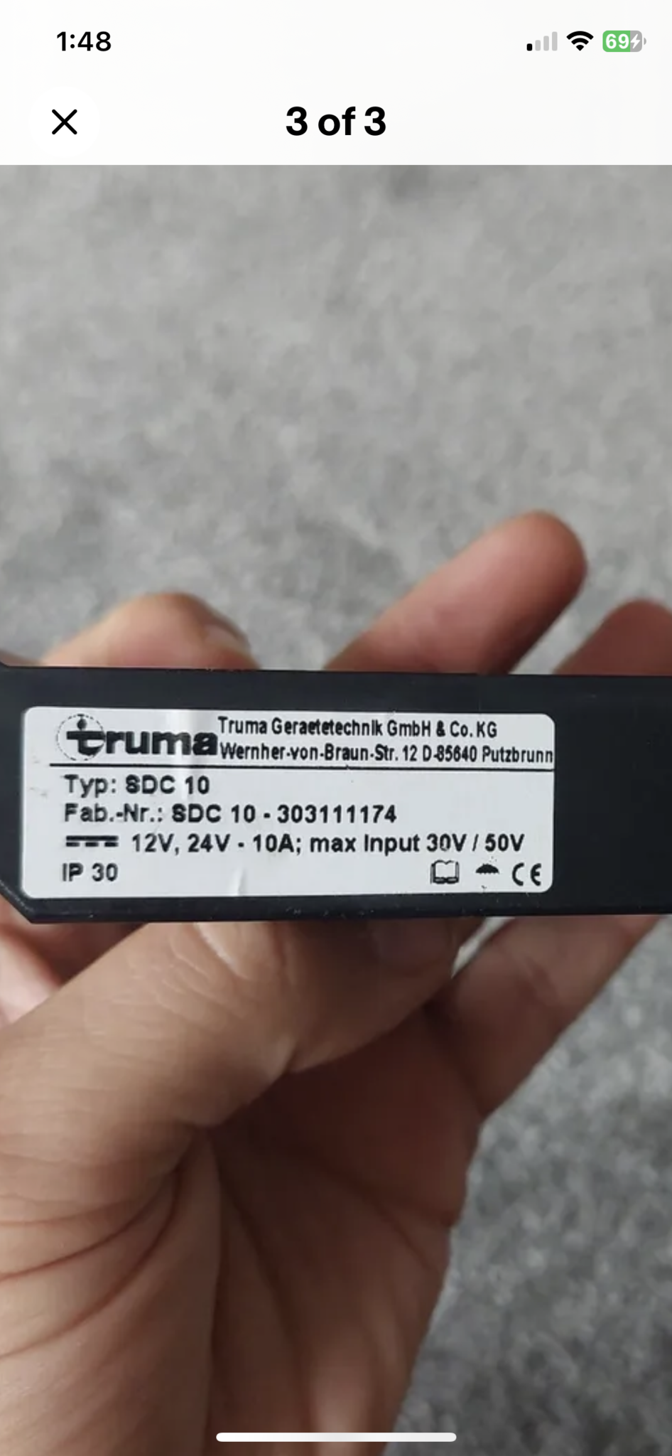

Hi I’m thinking of putting a extra solar panel on motorhome I have a Truma 100w on now and thinking of putting another 100w panel do I have to put a Truma panel or can I put any 100w panel on.

It doesn't have to be a trauma panel but you need to add a panel with a similar output. You also need to check that your controller will accept another panel as it's a standard pmw controller supplied with elddis.

This is the unit in will this not do the job or do I have to change it if so can you recommend a alternative one
