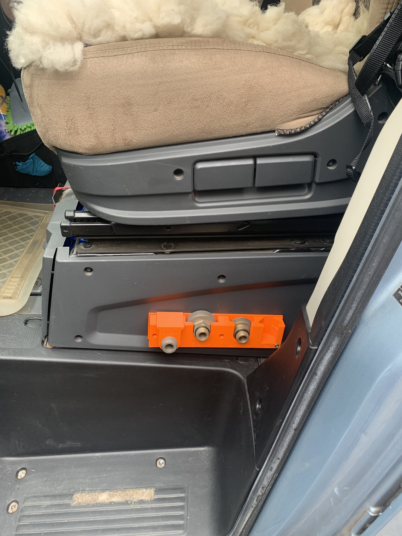

PaulandChrissy have been very successful with their 3D printer and have made loads of stuff for vans. I purchased a few bits and my Best Buy is definately the water filler funnel - my feet haven’t got soaked since I bought it!!!
Photo is of the lpg European adaptors holder.

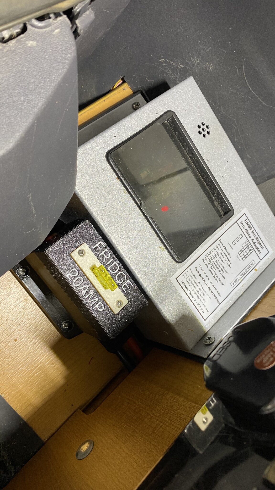

My latest print to sort out the melted fridge fuse in the Sargent EM50 interface box. Now fitted with a standard blade fuse rather than the mini fuse on the circuit board. Only gets slightly warm with the standard 20amp fuse

That is quality. Do you sell them?

I only made this one for myself, but if you need one the same let me know. We are in Spain at the moment. Back middle of March. Give me a nudge around the 15th March and I can make one for you.

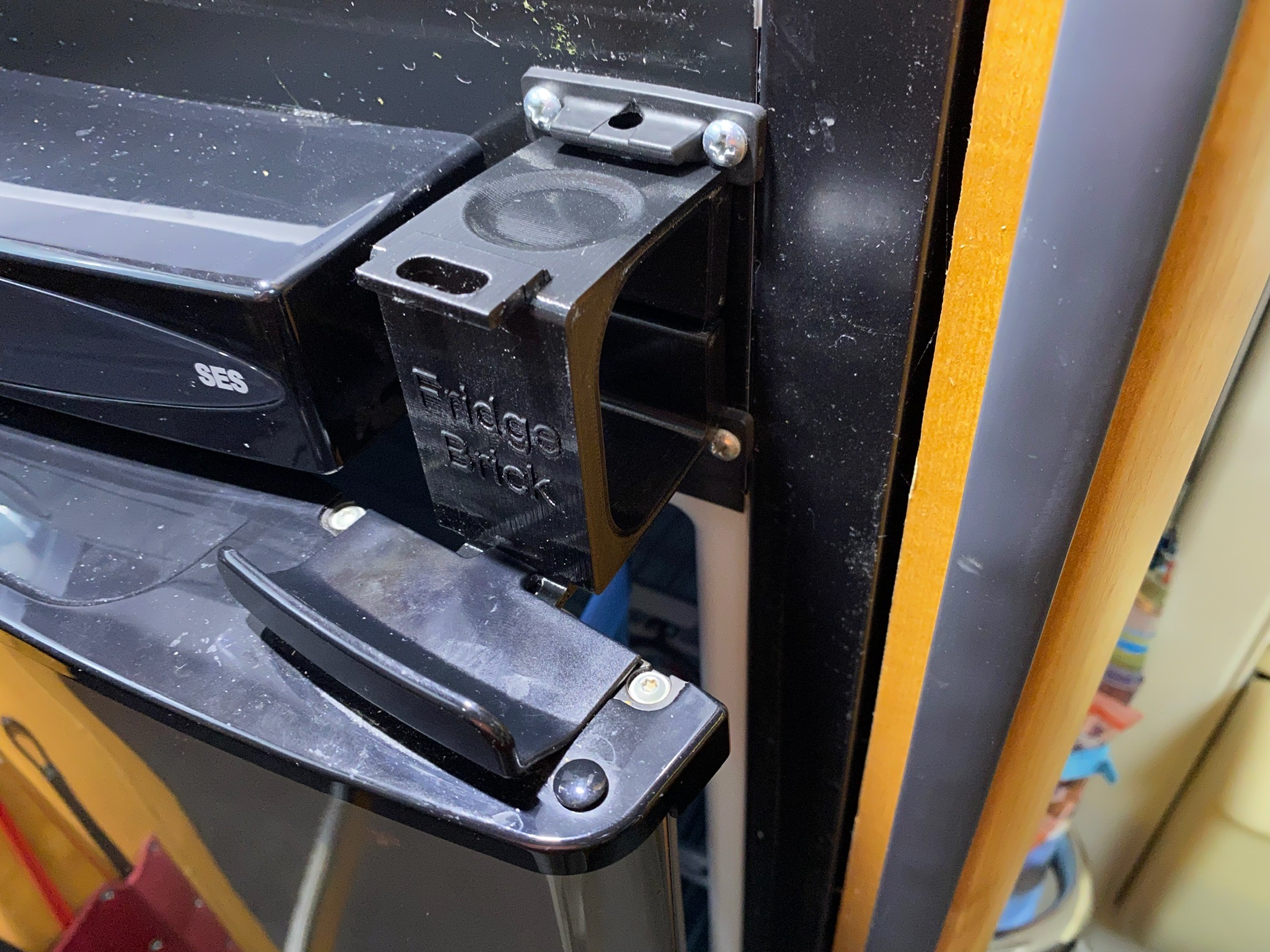

You've given me an idea to print a better catch to hold the hand door open!
Is this what you’re looking for. Do you want the STL files. I designed this a while back for our fridge. I call it the fridge brick.
