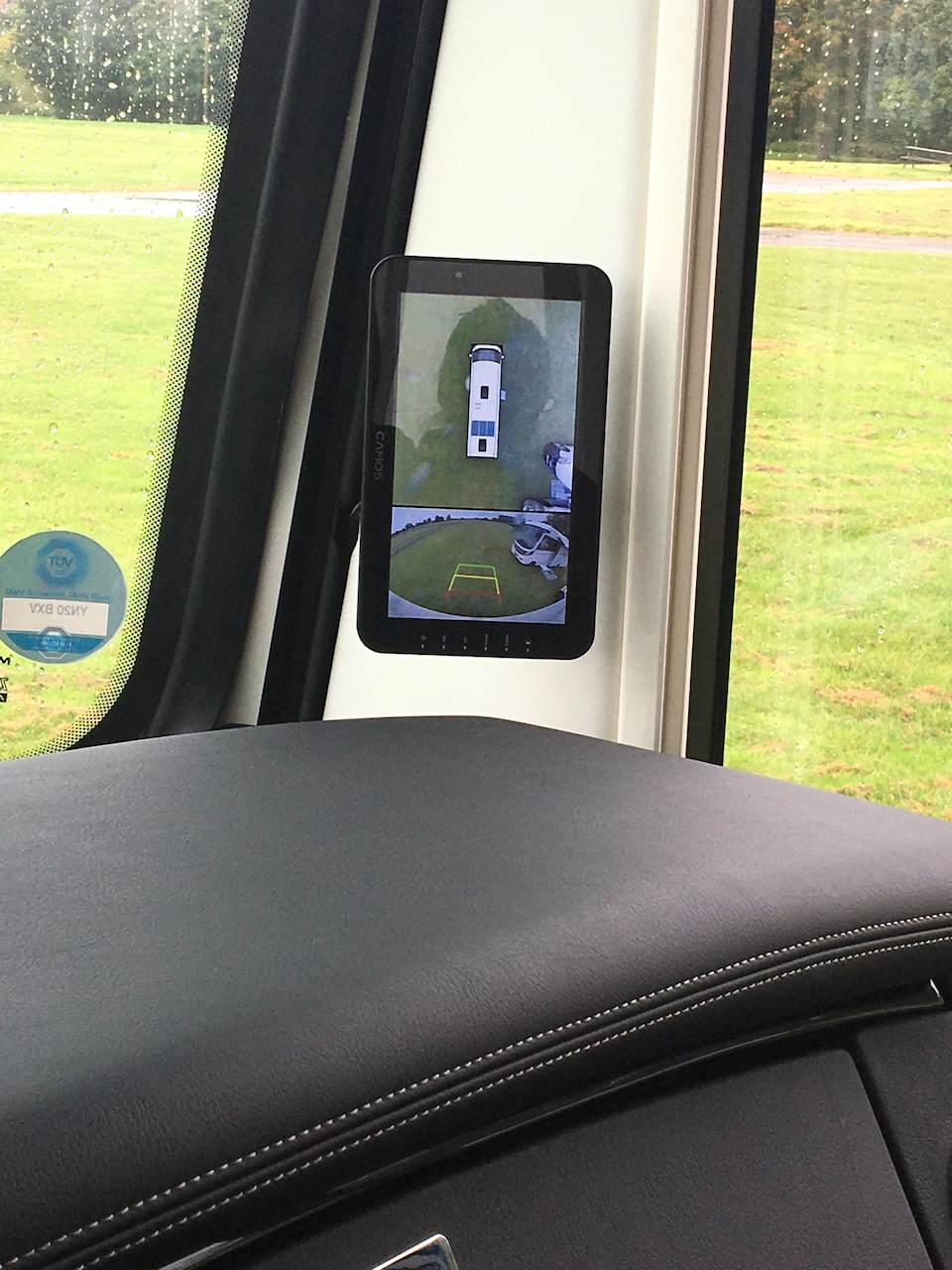

We have full 360 from 4 cameras mounted centrally front and rear and likewise centrally either side, the software stitches the image for overhead shot but you can select each camera manually as well.
Camera front
Drivers side screen on right indicator view,
Passenger side mirror showing reversing view.
Note that both screen have to show the same image at the same time though.
Camos HD 360 system, https://www.trailervision.co.uk/360sv-leisure
Ours was the first twin monitor system they had done but the fitter was brilliant and made up the wiring harness sat in a field.

I somehow don't get those screen shots. View from above indicates that the other vehicles are on the right (UK offside), but the reversing view appears to show them on the nearside?
Geoff
You got me thinking there :unsure: but yes the rear view image is reversed so that it is effectively what you would see in a mirror, anything else would be very confusing I think;)
I actually think that is not what you would see in a mirror, the obstruction would be on the other side. I think :unsure: :unsure: :unsure:
Geoff
You are correct. When i fit my high level rear view cameras I reverse them so they show the exact view behind as if i was facing backwards. My rear facing number plate camera, which i use for reversing against walls & which is perfect for positioning the ball hitch under the trailer coupling , shows a reversed image.
Geoff
It’s what I see in my mirrors 😊 the camera image is reversed but if you wanted it showing the original image they would do that do for you I’m sure.
