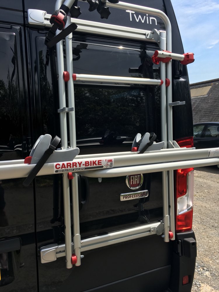

We did a temporary fix on the bike rack door of our Adria twin before we went away as we were concerned about the doors being blown open and smashing the light cluster and window, particularly the first opening door with the bike rack and extra weight.
We bought a fiamma bike block D1, took it apart and screwed it to the the bike rack so when the door opens the head of the block rests against the edge of the van and stops it opening any further. In the picture top right.
Worked very well and was well tested in the strong winds we encountered in Spain.
It’s needs addressing and we hope to find some permanent solution for both doors, wouldn't want to have to replace expensive light clusters.
