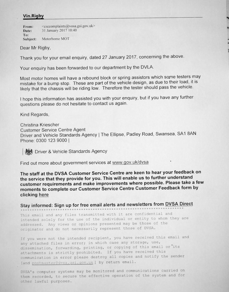

vin0114
Feb 8, 2014
1,662
4,673
Sheffield
30,022
Eldis Majestic 115
Vans and tugs since mid 70's
I DON'T BELIEVE IT.....WONDERS NEVER CEASE :party2:
Minxy
Aug 22, 2007
32,649
66,541
E Yorks
149
Carthago Compactline
My goodness ... confirmation at last that those of us who said they were spring assistors weren't all talking b*llocks then ... despite what some other say ... I suggest anyone who has a Fiat/Peugeot etc keeps a copy of this email handy for MOT time!!!

Yes Vin i already studied that link. The authorities have known for quite a while and seem to be dragging their heels.
I have contacted DVSA and so far have had this reply.
Thank you for your email enquiry dated 27th January 2017, concerning the above.
I have contacted the Private Vehicle Scheme Management Policy & Standards Team for advice in relation to your enquiry and you will receive a full response as soon as we have the relevant information.
I hope this information has assisted you with your enquiry, but if you have any further questions please do not hesitate to contact us again.
Kind Regards
Tina
Hopefully we will get an updated answer.
