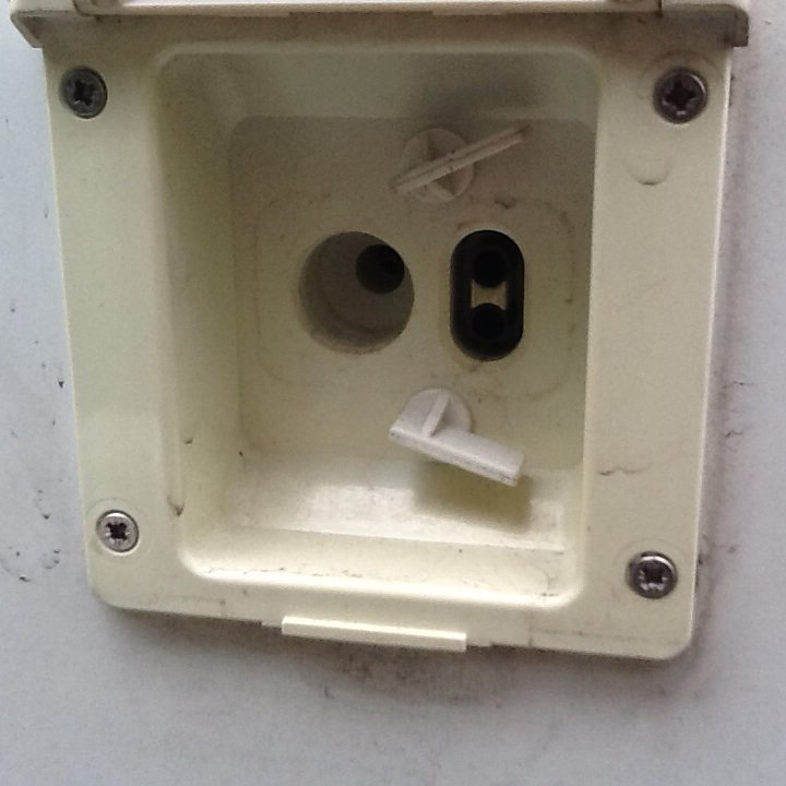

Lol there's always one
Not if it's like ours
