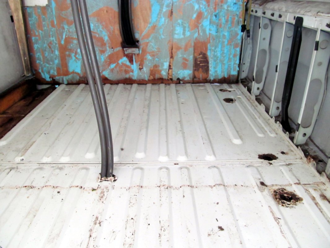

Well, I've decided to go ahead and strip it out. I threw a bucket of water onto the floor and it is draining away as it should do, down the drainage holes. The floor itself is in excellent condition and underneath the van is in excellent condition. I'll post the results, good or bad.
just wandering
just wandering
Feb 12, 2015
46
45
Paisley
35,080
Van Conversion
I'm a newbie
It's been a long time coming, I kept on getting pulled away to other things going on with family, but here are the results.
After making the decision to go ahead and strip out the insulated compartments, I did a little more research into the materials used. The top layer of the insulated floor was made of fibreglass with a screed of resin and was virtualy impregnable.
So stripping commenced and this is the progress so far.
As you can see, there is very little corrosion at all - well pleased!
The units are still installed as i'm trying to sell them, that's why the roof insulation is still in place to support the weight of the units.
This was done about 10 days ago and i'm now in the process of grinding down/repairing the rusty bits on the exterior (photos to follow on completion) hopefully within a few days.

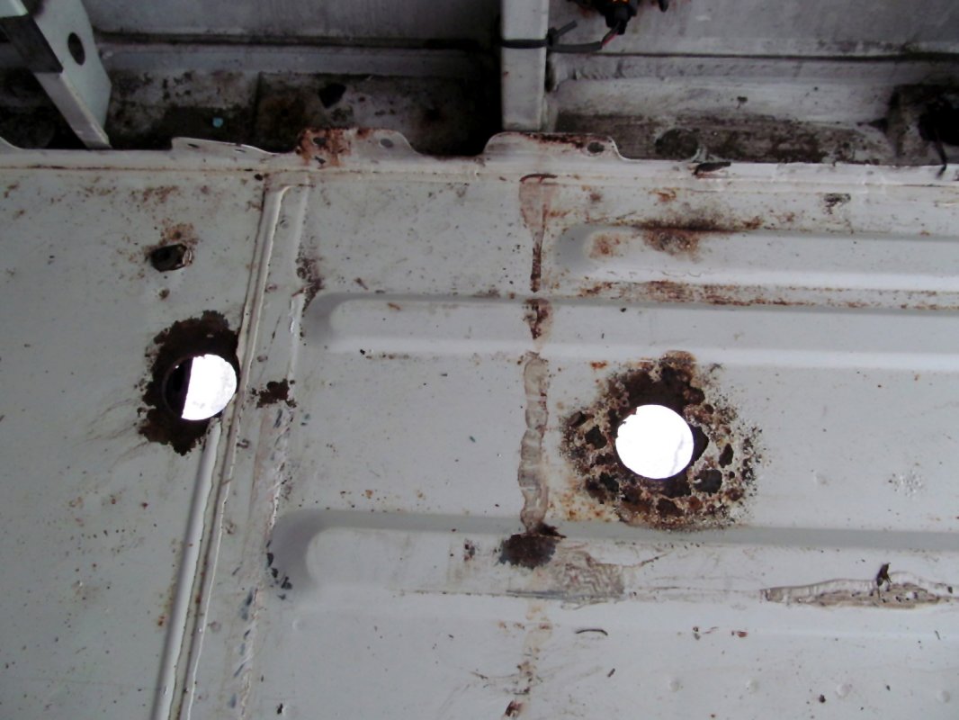

use this stuff to treet the rust this is the best stuff i have fund http://jenolite.net/
good luck with the project think you have ben very lucky rust wise
bill
Cheers for the link Bill! I've ordered some original and will be delivered tomorrow (friday). Lucky indeed, the neighbours must have been wondering what was going on in the van (shouts of joy, yes ya beauty and all that) when the original floor was finaly revealed.

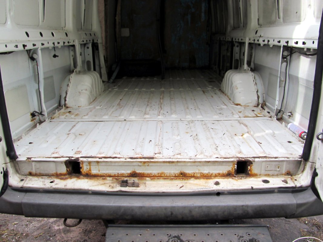

Sorry, no photos as of yet. I had intended to post photos when I finished repairing rust spots on the exterior. Then I decided to repair the rust in the interior and then post photos.
Well, I have been working on the van almost every day since the last posting.
The exterior rust spots are repaired, stickers removed and the whole exterior has had T-cut Original applied with only a 1st coat of primer applied, just can't seem to get that perfect day for spray painting.
The interior floor and walls are almost rust free, all the glue removed that was used for fixing the batons to the floor and walls and T-cut Original applied and a 1st coat of primer applied, from the cab all the way to the back doors.
I now have full access to the interior of the side sliding door that has not been opened since I got the van. I almost had it fixed, but at the last second I decided to put it back to the stuck position as there was a high probability that it could have fallen off onto the road by the time I got from the interior to the exterior of the door. I will need a helping hand with it to be on the safe side.
